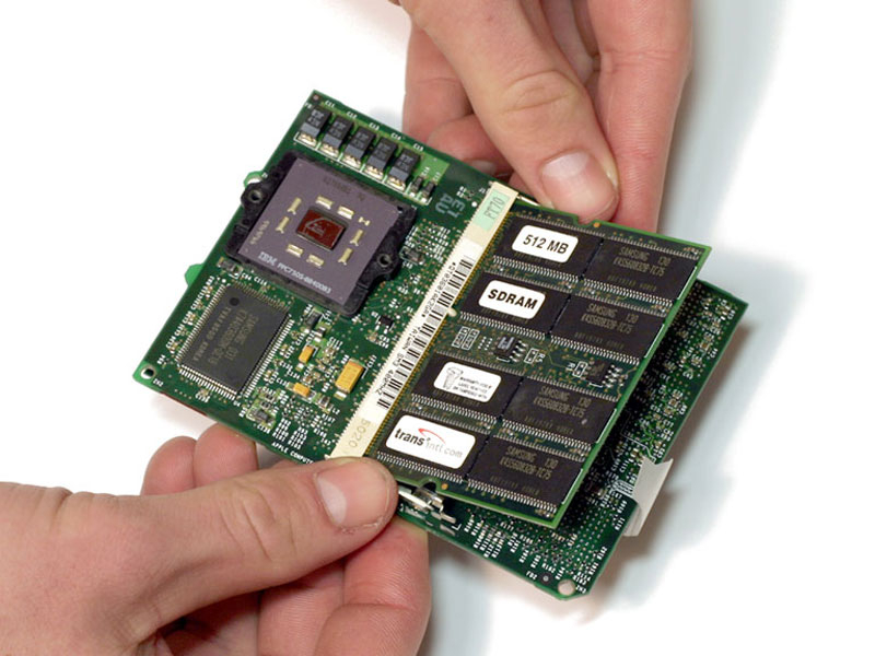

Add Note Edit Step 12 — Processor  ¶
  • Grasp the plastic tab on the processor's right side and pull it directly up.
  • Some processors may be missing the plastic pull tab. In this case, we suggest using a non-metal tool to gently pry up the processor. Slip the tool's thin edge under the front right corner of the processor and carefully pry it up.
first image
Add Note Edit Step 13  ¶
  • Your laptop should look approximately like this.
first image
Add Note Edit Step 14 — RAM  ¶
  • Release the tabs on each side of the RAM chip at the same time. These tabs lock the chip in place and releasing them will cause the chip to "pop" up.
  • Pull the RAM chip out.
  • There are RAM slots on both sides of the processor. We recommend installing higher capacity chips on the bottom so that if you want to upgrade later, you won't have to remove the processor.
