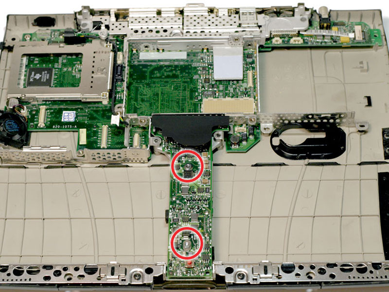

Add Note Edit Step 39 — Power Card  ¶
  • Remove the two long silver Torx screws from the power card in the center of the laptop
first image
Add Note Edit Step 40  ¶
  • Grasp the power card near the black shield and lift up.
