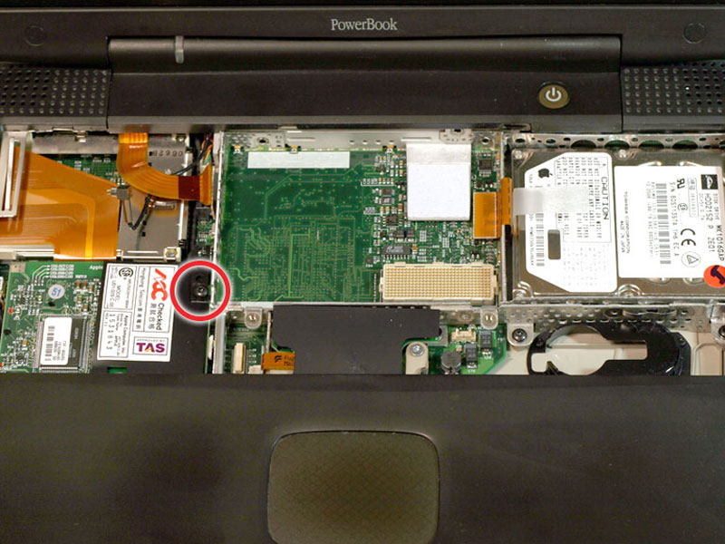

Add Note Edit Step 14 — Modem  ¶
  • Remove the black Torx screw from the right side of the modem.
  • Remove the small black plastic rectangle with four holes.
first image
