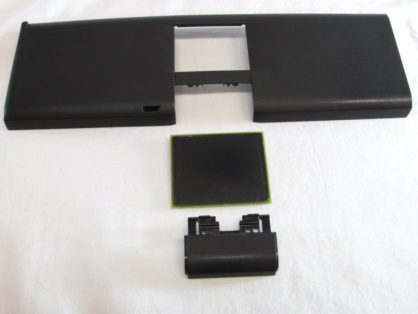

How to replace the track pad once the track pad panel has been removed.
Your track pad is one of the most important parts of your PowerBook's user interface. If the track pad is damaged you will need to use an external mouse or replace the track pad. This is one of the hardest parts to get to in the computer. Before attempting, make sure you will be able to keep the removed parts organized to aid in reassembly.

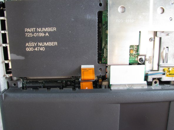

  • Push the display screen back to give yourself enough space to remove the side panels.
  • Before removing the side panels, note that removing the side panels hastily will damage the underlying panel screw. However, this will not affect the functionality of your PowerBook.
  • Remove the panels on either side by gently but firmly pulling up on them with both hands.
Image #1 Image #2
Add Note Edit Step 8  ¶
  • Use the plastic opening tool to lift up the tabs on either side of the ribbon cable port and then gently pull the ribbon cable free.
