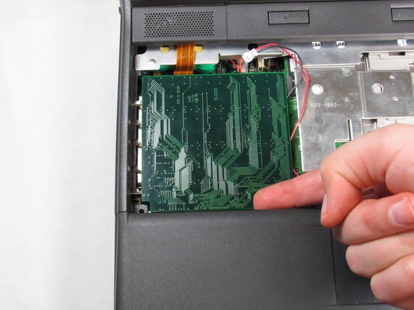

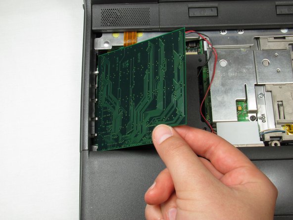

Add Note Edit Step 6 — RAM  ¶
  • Gently wiggle the RAM card to loosen the connection until it pulls free.
Image #1 Image #2

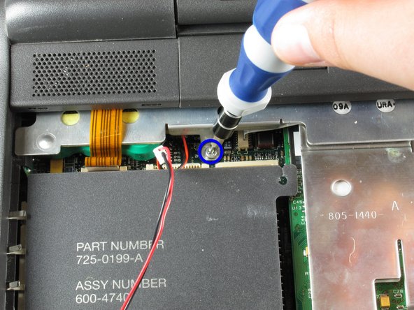

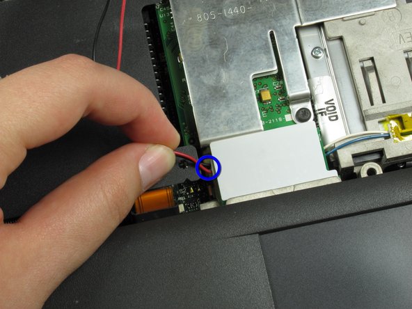

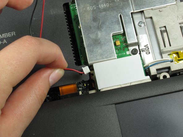

Add Note Edit Step 7 — Speaker Panel  ¶
  • Disconnect the wires from the port.
Image #1
Add Note Edit Step 8  ¶
  • Remove the 7mm screw connecting the speaker panel to the computer.
