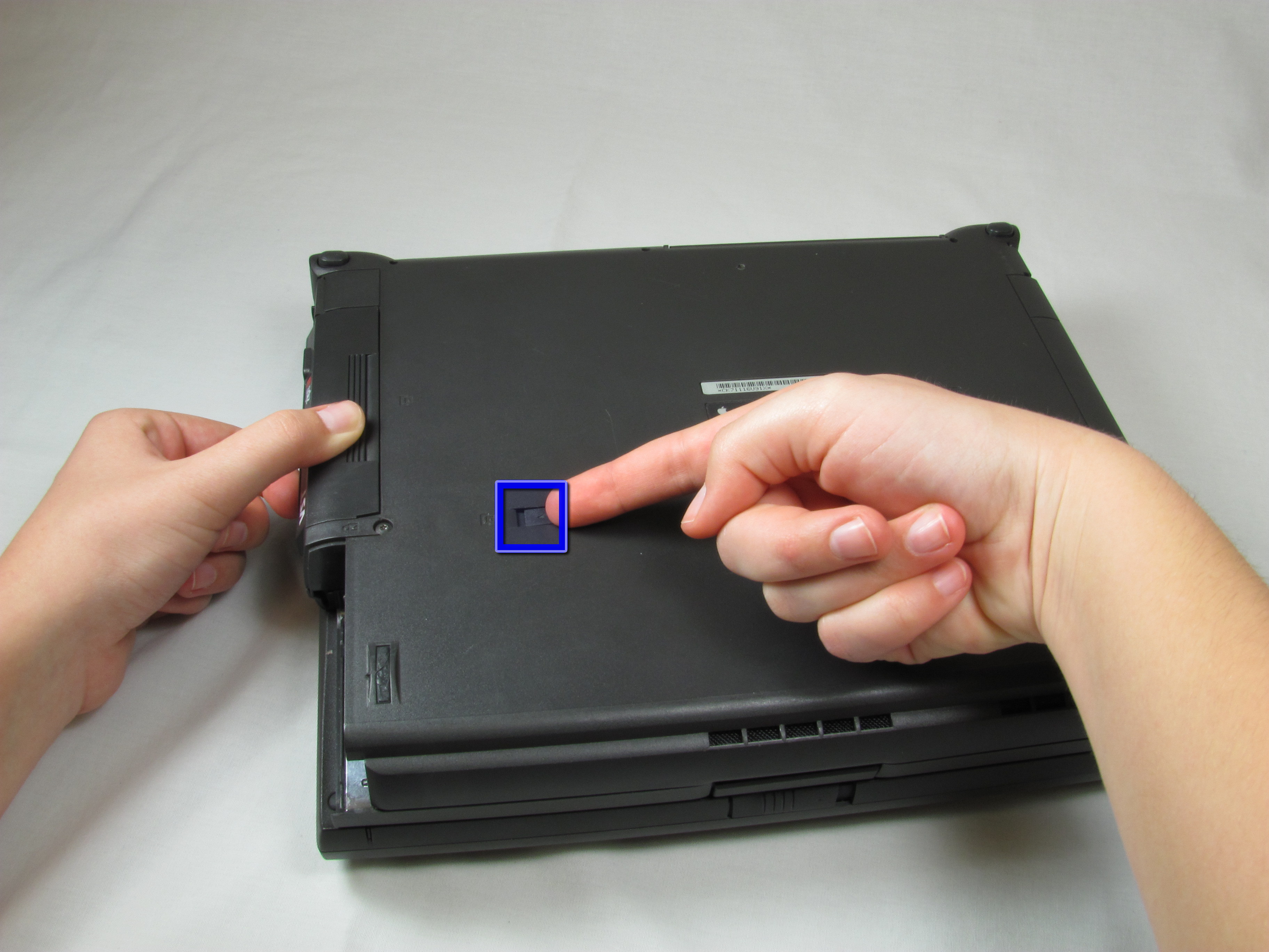

Image #1
  • Close the screen and turn the PowerBook over. Orient the computer so the text of the label is right side up.

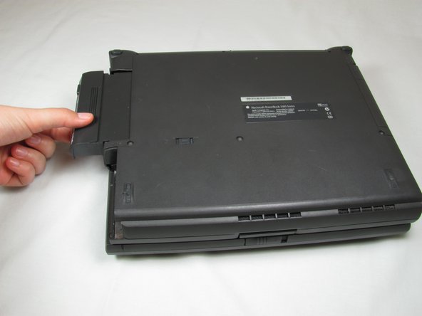

Image #1 Image #2
Add Note Edit Step 2  ¶
  • Press and hold the button on the left of the front side and slide the battery out.

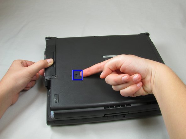

Add Note Edit Step 3 — Floppy Disk Drive  ¶
  • First, slide the switch on the back of the computer to the left.
  • Then pull the floppy drive out of the computer.
