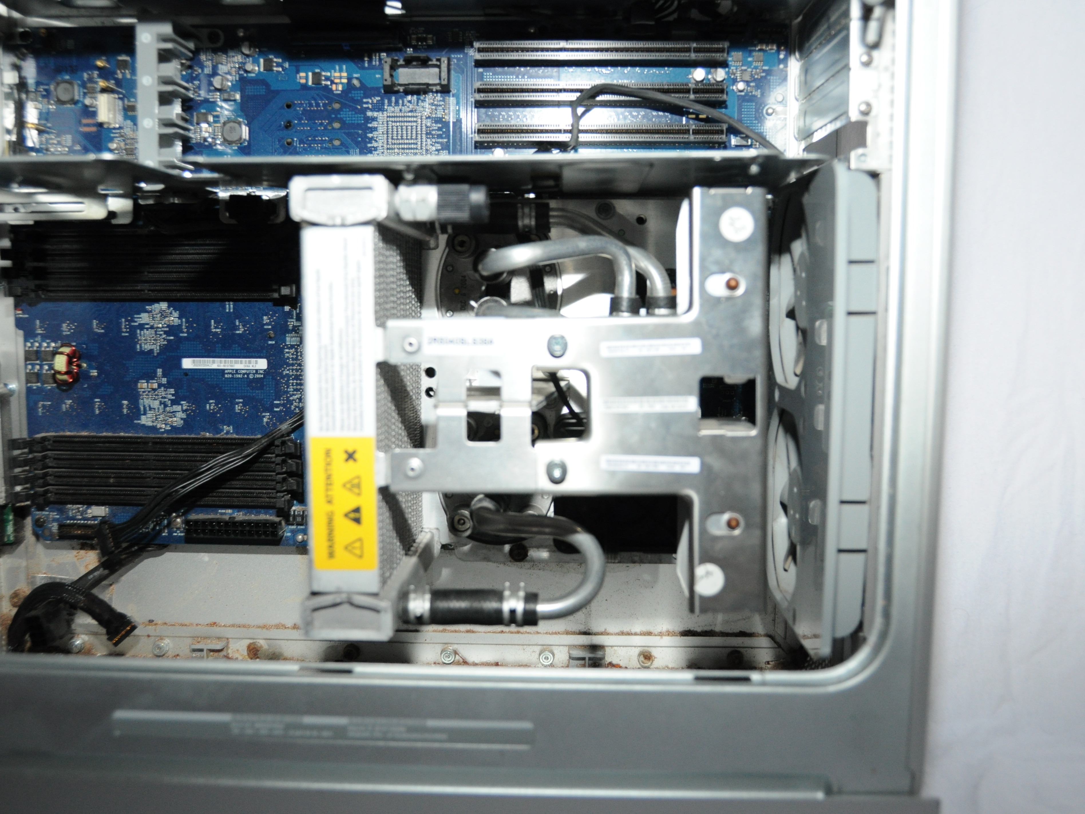

This will overview the process to remove and replace the Cooling and Processing unit of the Apple G5. Due to design restrictions of the device it is difficult replace the just processors without permanently damaging the entire unit. So this portion of the guide will only overview removal of the entire unit.
Image #1
Add Note Edit Step 1 — Side Panel  ¶
  • To avoid electrocution, shut down the computer. Do not open the computer or attempt to install any items inside it while the computer is on.
  • To avoid being shocked, wait at least 10 minutes to allow the computer's internal components to cool.
Image #1
Add Note Edit Step 2  ¶
  • Remove all the cables, including the power cables before opening the unit.
Image #1 Image #2
Add Note Edit Step 3  ¶
  • Lift the tab to unlock the side panel.
  • The panel should fall out. If the panel does not fall out by itself pull a little from the edges.
Image #1 Image #2 Image #3
Add Note Edit Step 4  ¶
  • Remove the air deflector (the clear plastic cover) by pulling on the handle.
Image #1
Add Note Edit Step 5 — Front Fan Assembly  ¶
  • Locate the front fan assembly.
Image #1
Add Note Edit Step 6  ¶
  • Pull the fan assembly out; it should slide out easily.
Image #1 Image #2
Add Note Edit Step 7 — Bottom Right Cooling Fan Unit  ¶
  • The cooling fan unit is located on the bottom right of the Apple G5 Desktop.
Image #1
Add Note Edit Step 8  ¶
  • Remove the G5 metal cover from the processing/cooling unit of the computer. NOTE: Apple inserted a rather fragile plastic pin that inserts through the top divider shield and clips into a tab on the hidden ledge of this CPU shield. Removing this pin, certainly voided Mac's warranty - but more appropriate for now, voids most after-market insurance plans. A replacement pin (new) is hard to get ahold of, and very few are talented and patient enough to remove this pin without damaging it. Just something to keep in mind. If you have no warranty any longer or don't care, please continue...
  • Pull the metal plate to the left and outward to remove the plate from the processing/cooling unit.
