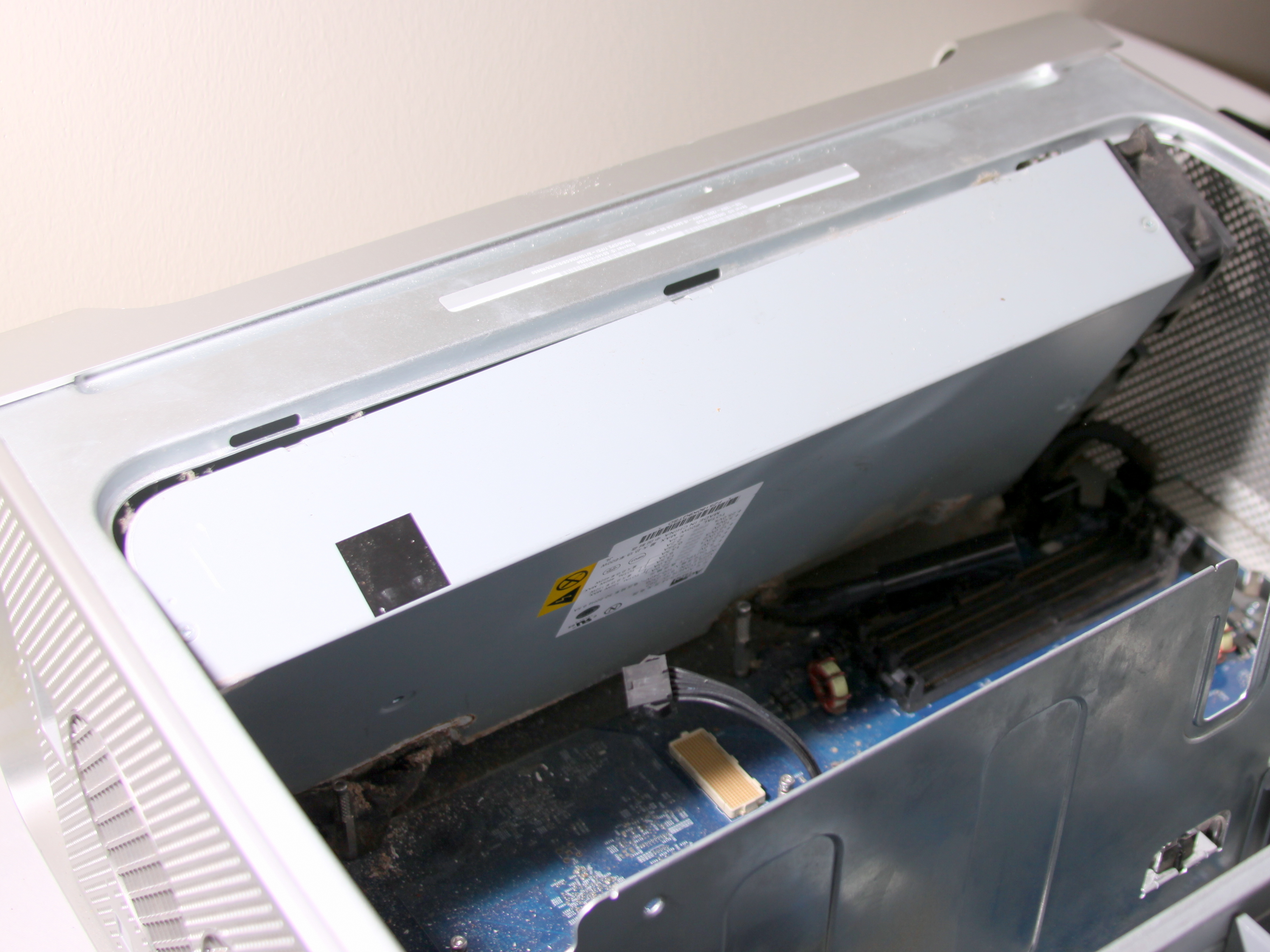

Add Note Edit Step 14 — Processor and Cooling Unit  ¶
  • Locate the Cooling Unit on the Apple G5.
  • Put the CPU case on its back with the opening facing up to make the next steps easier.
Image #1
Add Note Edit Step 15  ¶
  • Unscrew 8 T10 screws from the cooling unit. G5 models with the large Fujikura heat sinks (not shown in picture) will have 8 2.5mm hex screws.
  • The screws are somewhat hidden, so they cannot be see in the picture.
  • To visualize the location of the screws look 3 steps ahead.
  • The screws will loosen but will not come out, they are designed to loosen the unit, but remain in place.
Image #1
Add Note Edit Step 16  ¶
  • Pull the cooling/processing unit straight up to prevent damage to logic board
  • This will require some effort and should be done with caution to avoid damage.
  • The sleeves around the 6 screws may hold it in, if so just take a pair of needle nose pliers and gently squeeze the sleeves until it releases.
  • Pull the bottom, then side towards the bottom of the CPU case, first to move around the bottom coolant sleeve around the heat sinking bracket. *heat sinking bracket not in picture*
