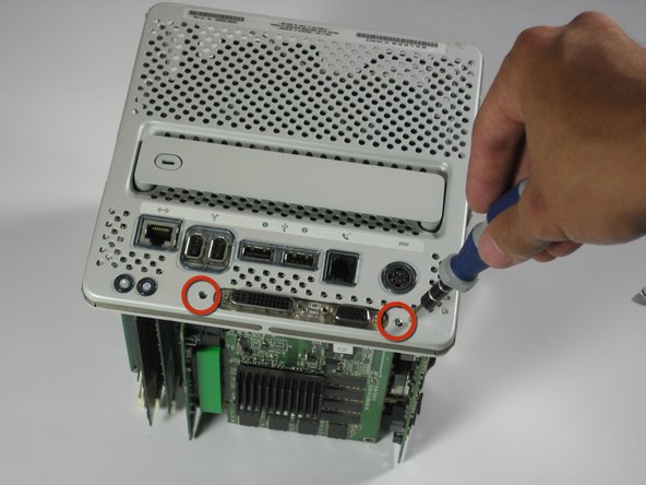

  2. Power Mac G4 Cube Modem Replacement: step 2, image 1 of 2 Power Mac G4 Cube Modem Replacement: step 2, image 2 of 2
    • Place the cube upside down and remove the four T10 Torx screws on the front plate. Then remove the two screws on each side.

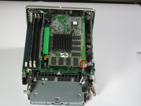

  6. Power Mac G4 Cube Modem Replacement: step 6, image 1 of 1
    • Remove the screw attaching the video card to the logic board.

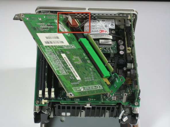

  7. Power Mac G4 Cube Modem Replacement: step 7, image 1 of 2 Power Mac G4 Cube Modem Replacement: step 7, image 2 of 2

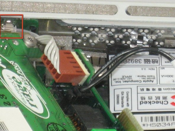

    • Remove power cord from the video card.
  8. Power Mac G4 Cube Modem Replacement: step 8, image 1 of 1
    • Remove the power cord.
    • Remove the connector.
    • Remove the video card from the logic board.
  9. Power Mac G4 Cube Modem Replacement: step 9, image 1 of 1
    • Carefully lift the video card from the logic board.
    • The video card should come out easily.

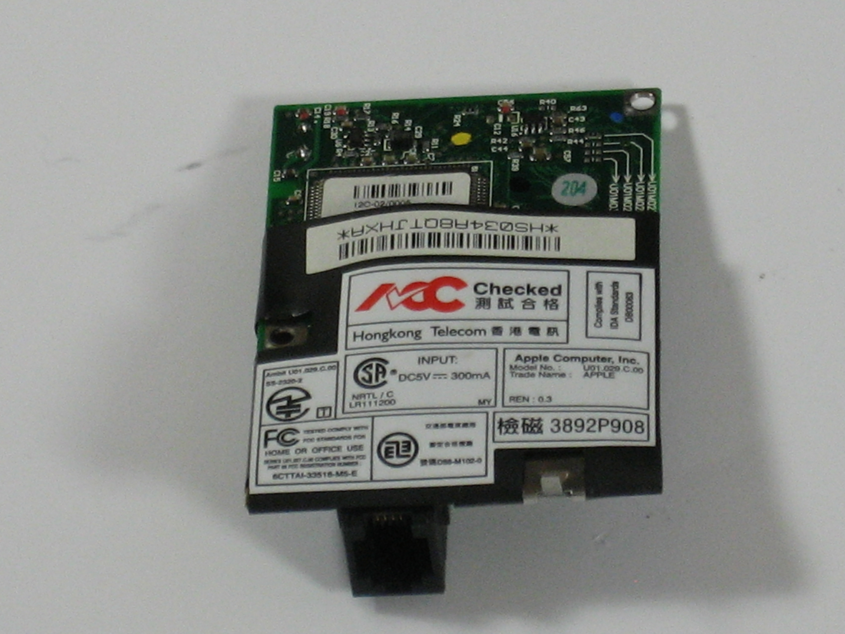

  11. Power Mac G4 Cube Modem Replacement, Modem: step 11, image 1 of 1
    • Remove the two screws from the modem.
  12. Power Mac G4 Cube Modem Replacement: step 12, image 1 of 1
    • Lift modem from the Logic Board.
    • The modem should come out easily.
