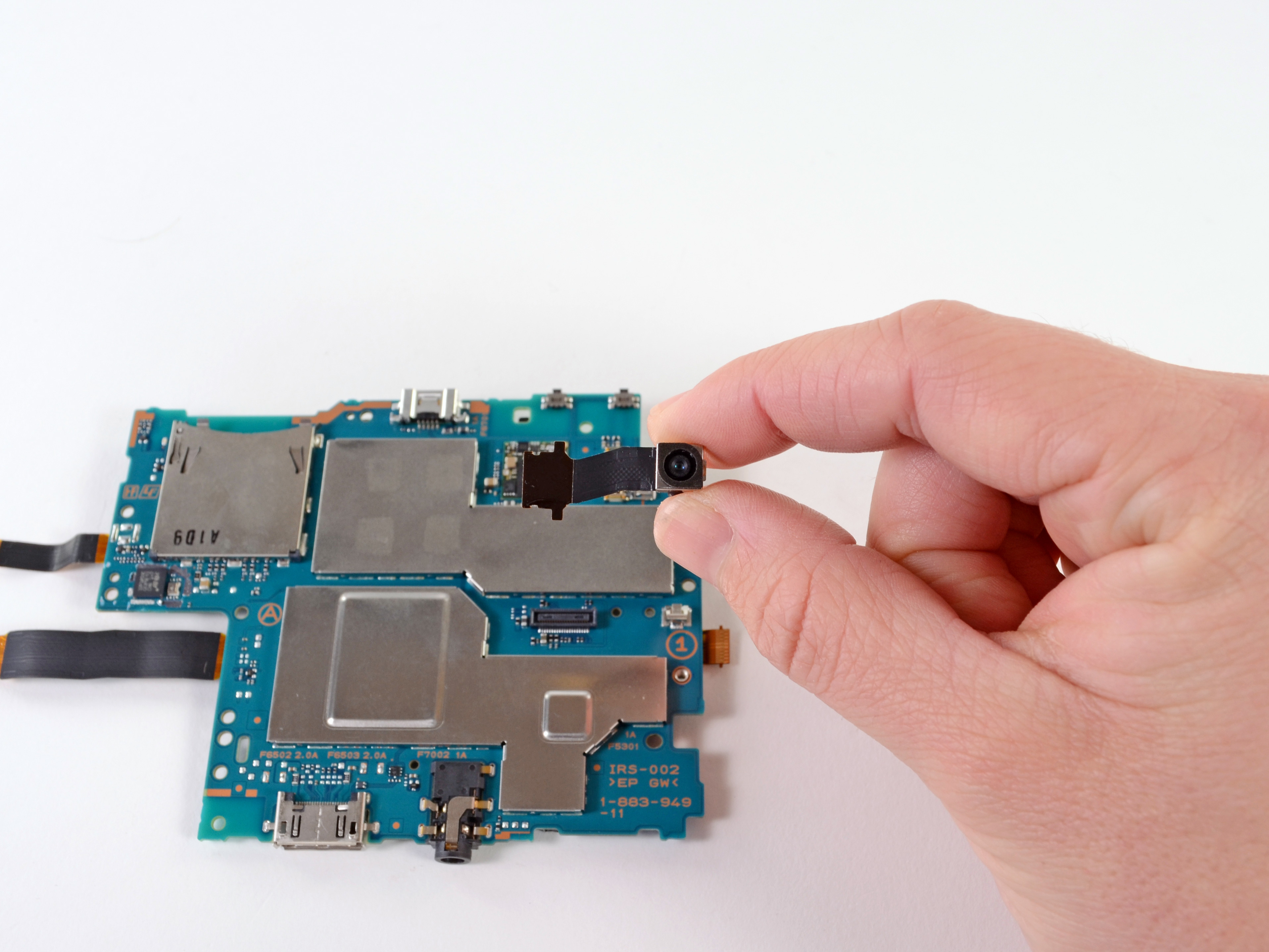

Install the rear camera on the PlayStation Vita.
This guide takes you through the process of installing the rear camera on the PlayStation Vita.
