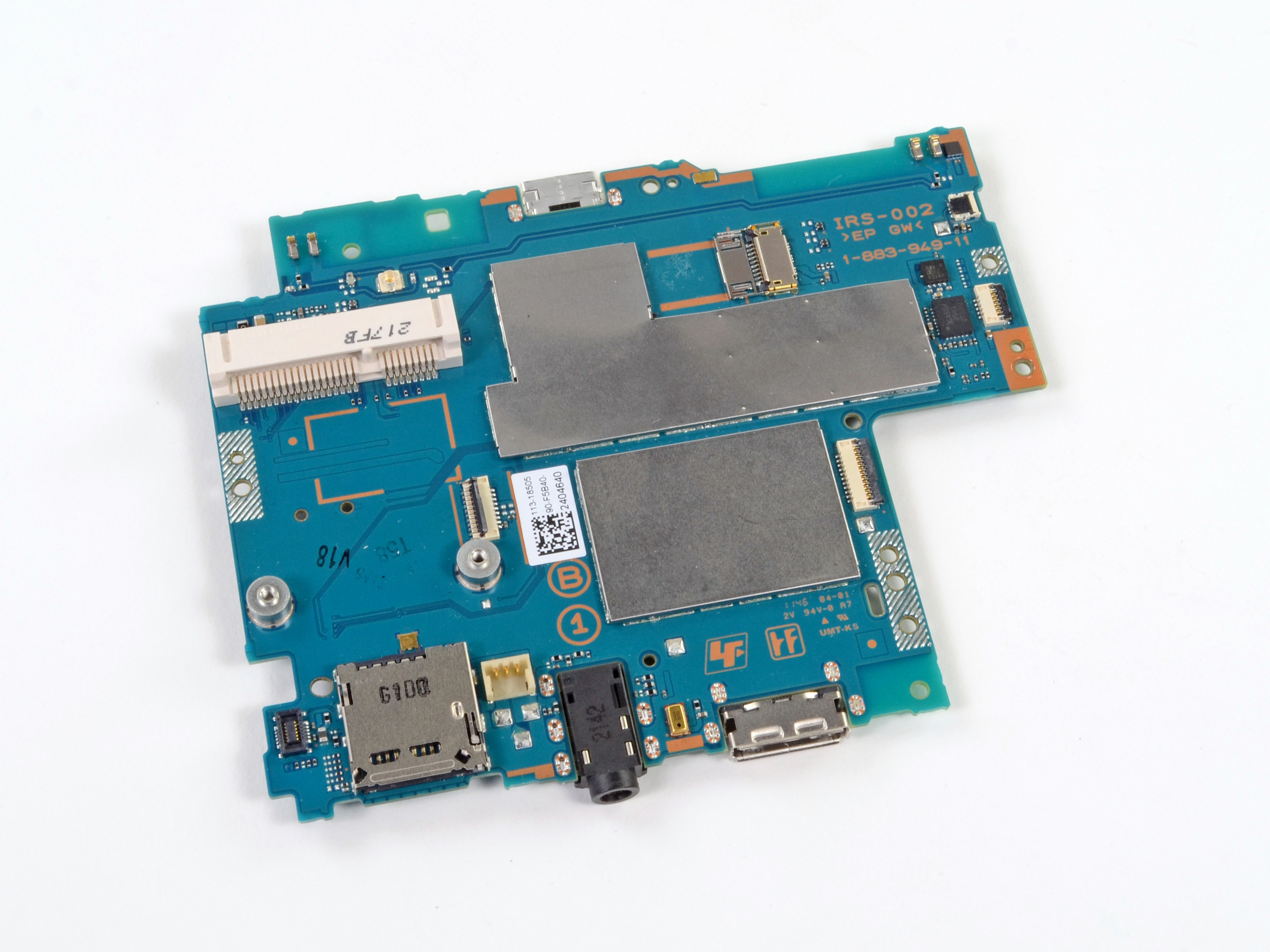

  • Flip the motherboard over.
  • With the help of a spudger, pry up and release the tab of the rear camera flex cable connector.
Image #1 Image #2 Image #3
Add Note Edit Step 53  ¶
  • Gently pull the rear camera out of the connector and remove it.
Image #1
Add Note Edit Step 54  ¶
  • The motherboard remains.
