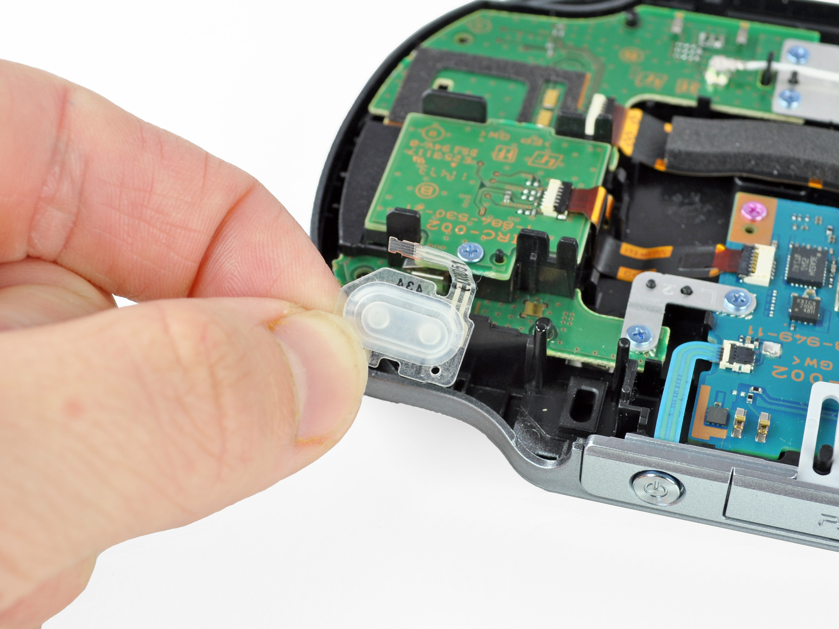

Installing PlayStation Vita Left Shoulder Button
Install the left shoulder button on the PlayStation Vita.
This guide takes you through the process of installing the left shoulder button on the PlayStation Vita.
Image #1 Image #2
Add Note Edit Step 1 — Case Separation  ¶
  • Using a Phillips #00 screwdriver, remove the four 6.4mm screws on the back casing.
Image #1 Image #2 Image #3
Add Note Edit Step 2  ¶
  • Using your fingernail or a spudger, pry open the accessory port cover on the bottom of the device.
  • Using a Phillips #00 screwdriver, remove the two 5.4mm screws hidden beneath the accessory port cover.
Image #1 Image #2
Add Note Edit Step 3  ¶
  • Remove the two 5.4mm Phillips #00 screws on the top of the device near the charging port.
Add Note Edit Step 4  ¶
  • Beginning at the sides of the device, use a plastic opening tool to separate the front and rear cases.
  • Continue working your way around the device gently prying it open.
  • There are still wires holding the front and rear cases together. You may damage the connections if you yank the cases completely apart.
Image #1 Image #2
Add Note Edit Step 5  ¶
  • Gently separate the two cases, minding the battery and the touch screen controller connectors holding the two cases together.
Image #1
Add Note Edit Step 6  ¶
  • Using a spudger, free the touch screen controller flex cable by gently prying up the connection.
Image #1
Add Note Edit Step 7  ¶
  • Free the battery cable by gently prying up on the connection with a spudger.
Image #1
Add Note Edit Step 8  ¶
  • Separate the front and rear cases.
