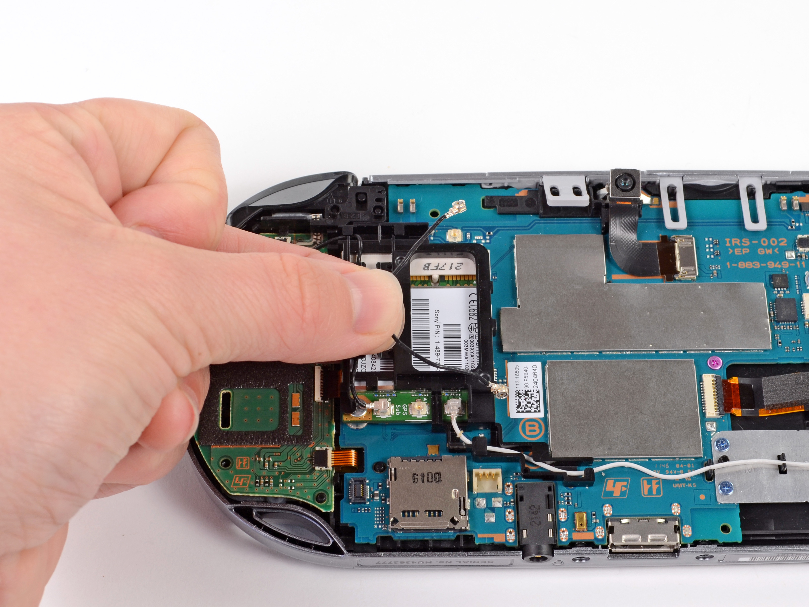

This guide takes you through the process of installing the GPS antenna cable. This is the middle antenna cable on the wireless card.

  • Using a Phillips #00 screwdriver, remove the four 6.4mm screws on the back casing.
Image #1 Image #2 Image #3
Add Note Edit Step 2  ¶
  • Using your fingernail or a spudger, pry open the accessory port cover on the bottom of the device.
  • Using a Phillips #00 screwdriver, remove the two 5.4mm screws hidden beneath the accessory port cover.
Image #1 Image #2
Add Note Edit Step 3  ¶
  • Remove the two 5.4mm Phillips #00 screws on the top of the device near the charging port.
Add Note Edit Step 4  ¶
  • Beginning at the sides of the device, use a plastic opening tool to separate the front and rear cases.
  • Continue working your way around the device gently prying it open.
  • There are still wires holding the front and rear cases together. You may damage the connections if you yank the cases completely apart.
Image #1 Image #2
Add Note Edit Step 5  ¶
  • Gently separate the two cases, minding the battery and the touch screen controller connectors holding the two cases together.
Image #1
Add Note Edit Step 6  ¶
  • Using a spudger, free the touch screen controller flex cable by gently prying up the connection.
Image #1
Add Note Edit Step 7  ¶
  • Free the battery cable by gently prying up on the connection with a spudger.
Image #1
Add Note Edit Step 8  ¶
  • Separate the front and rear cases.
