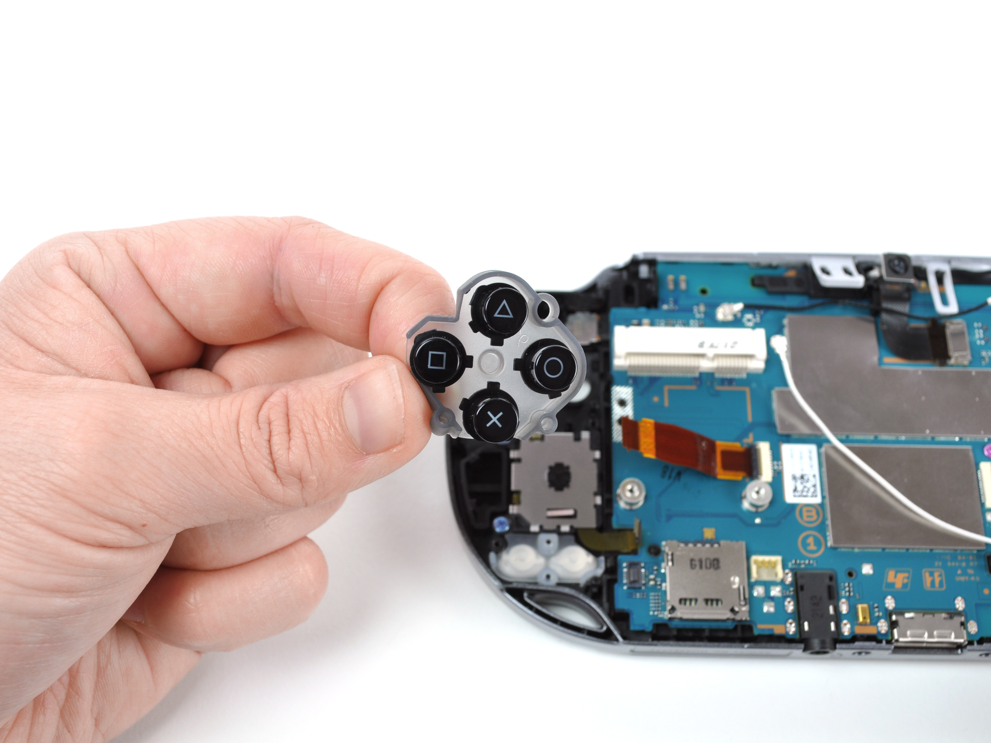

Add Note Edit Step 8  ¶
  • Separate the front and rear cases.
