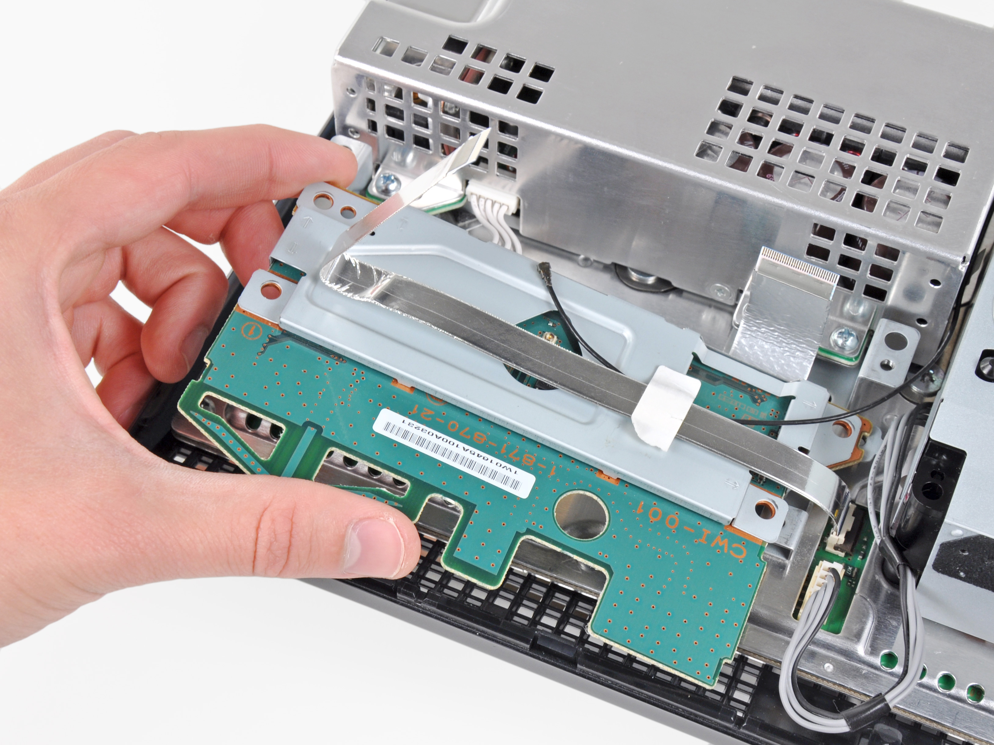

Add Note Edit Step 9 — Wi-Fi/Bluetooth Board  ¶
  • If necessary, peel the memory card reader ribbon cable off the Wi-Fi/Bluetooth board.
Image #1
Add Note Edit Step 10  ¶
  • Use the flat end of a spudger to pry the Wi-Fi antenna connector up from its socket on the Wi-Fi/Bluetooth board.
Image #1 Image #2
Add Note Edit Step 11  ¶
  • Use your fingernail to flip up the retaining flap on the Wi-Fi/Bluetooth ribbon cable socket.
  • Be sure you are prying up on the retaining flap, not the socket itself.
  • Pull the Wi-Fi/Bluetooth ribbon cable out of its socket.
Image #1
Add Note Edit Step 12  ¶
  • Remove the four 9 mm Phillips screws securing the Wi-Fi/Bluetooth board to the chassis.
Image #1
Add Note Edit Step 13  ¶
  • Remove the Wi-Fi/Bluetooth board from the PS3, minding any cables that may get caught.
