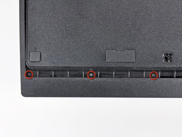

  • Use the flat end of a metal spudger to pry up the seven screw covers around the edge of the lower case.
Image #1
Add Note Edit Step 3  ¶
  • Remove the seven 37 mm Phillips screws securing the top cover to the lower case.
Image #1
Add Note Edit Step 4  ¶
  • Remove the three 13.3 mm T8 security Torx screws beneath the Blu-ray drive opening. (Some models may have a fourth screw on the corner.)
