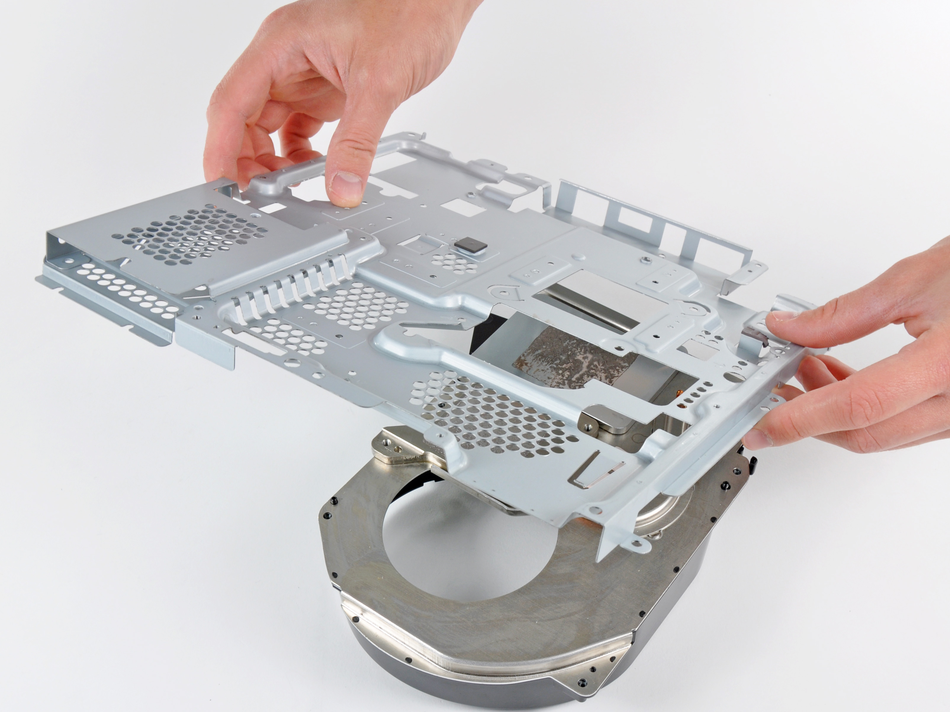

Add Note Edit Step 17 — Motherboard Assembly  ¶
  • Pull the AC-In cables upward to remove the AC inlet from the lower case.
Image #1 Image #2
Add Note Edit Step 18  ¶
  • Use the flat end of a spudger to pry both antenna connectors up from their sockets on the motherboard.
Image #1
Add Note Edit Step 19  ¶
  • Pull the control board ribbon cable up and out of its socket on the motherboard.
  • Remove the control board.
Image #1
Add Note Edit Step 20  ¶
  • Turn the PS3 over and lay it on its backside.
  • Use the flat edge of a metal spudger to pop up the small access door on the bottom cover near the front of the PS3.
  • Remove the blue Phillips screw hidden under the access door.
Image #1
Add Note Edit Step 21  ¶
  • Slide the hard drive bay cover toward the right side of the lower case, then pull it away from the front edge to remove it from the PS3.
Image #1
Add Note Edit Step 22  ¶
  • Using its attached metal handle, pull the hard drive out of its bay.
Image #1
Add Note Edit Step 23  ¶
  • Remove the following five screws securing the motherboard assembly to the lower case:
    • Two silver 6 mm Phillips
    • Three black 8 mm Phillips
Image #1
Add Note Edit Step 24  ¶
  • Lift the motherboard assembly from its front edge and remove it from the lower case, minding the antenna cable still attached to the lower case.
  • Be careful not to bend the metal antenna bodies as you lift the motherboard assembly.
