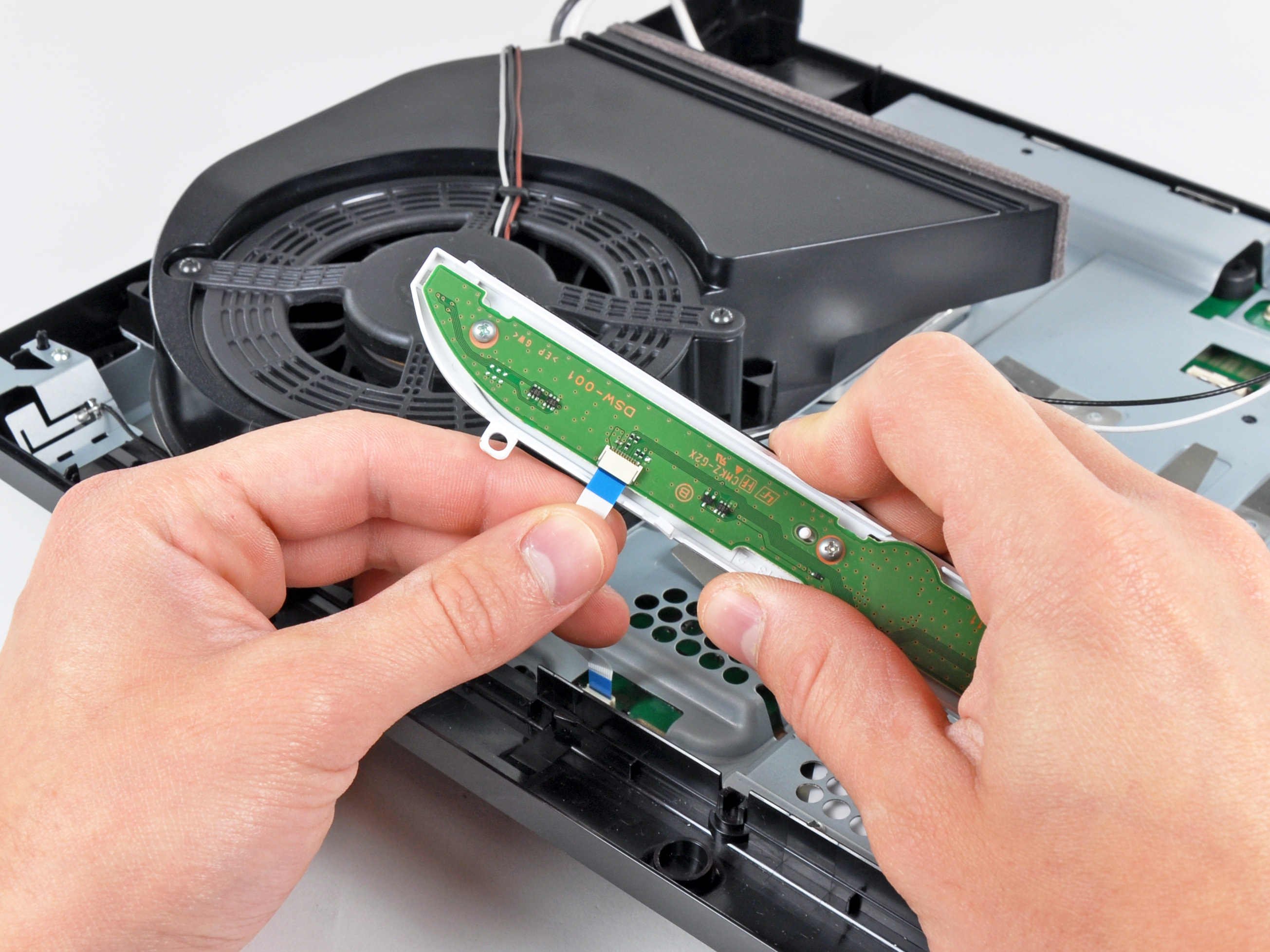

Add Note Edit Step 6 — Control Board  ¶
  • Use the tip of a spudger to pry the control board out of its housing within the lower case.
  • Pull the control board ribbon cable away from its socket on the control board.
