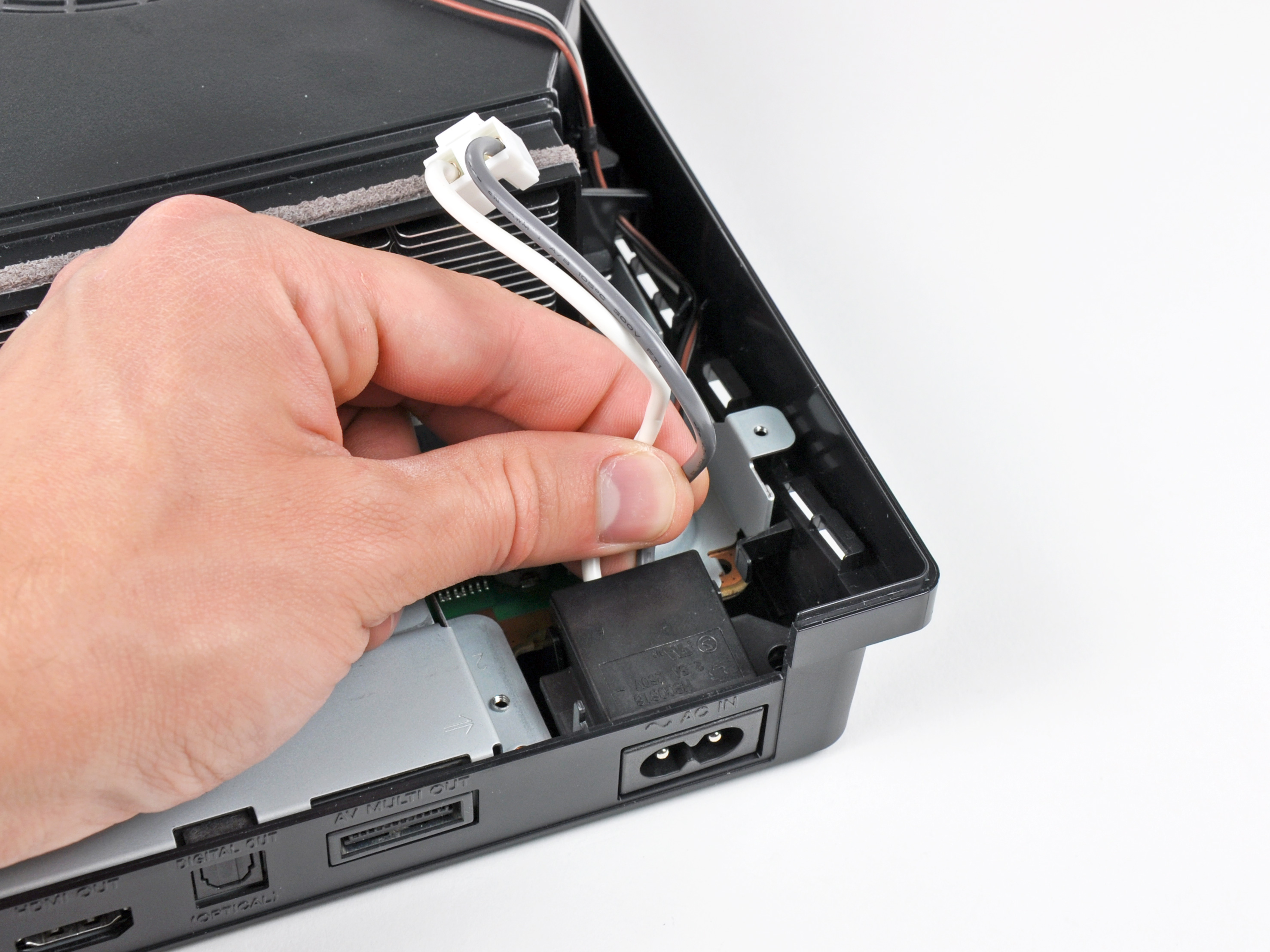

Add Note Edit Step 6 — Power Supply  ¶
  • Squeeze the AC inlet connector's locking mechanism and pull straight up to disconnect it from the power supply.
Image #1
Add Note Edit Step 7  ¶
  • Pull the DC-Out cables straight up to lift their connector up and out of its socket on the power supply.
Image #1
Add Note Edit Step 8  ¶
  • Remove the two 7.6 mm Phillips screws securing the power supply to the lower case.
