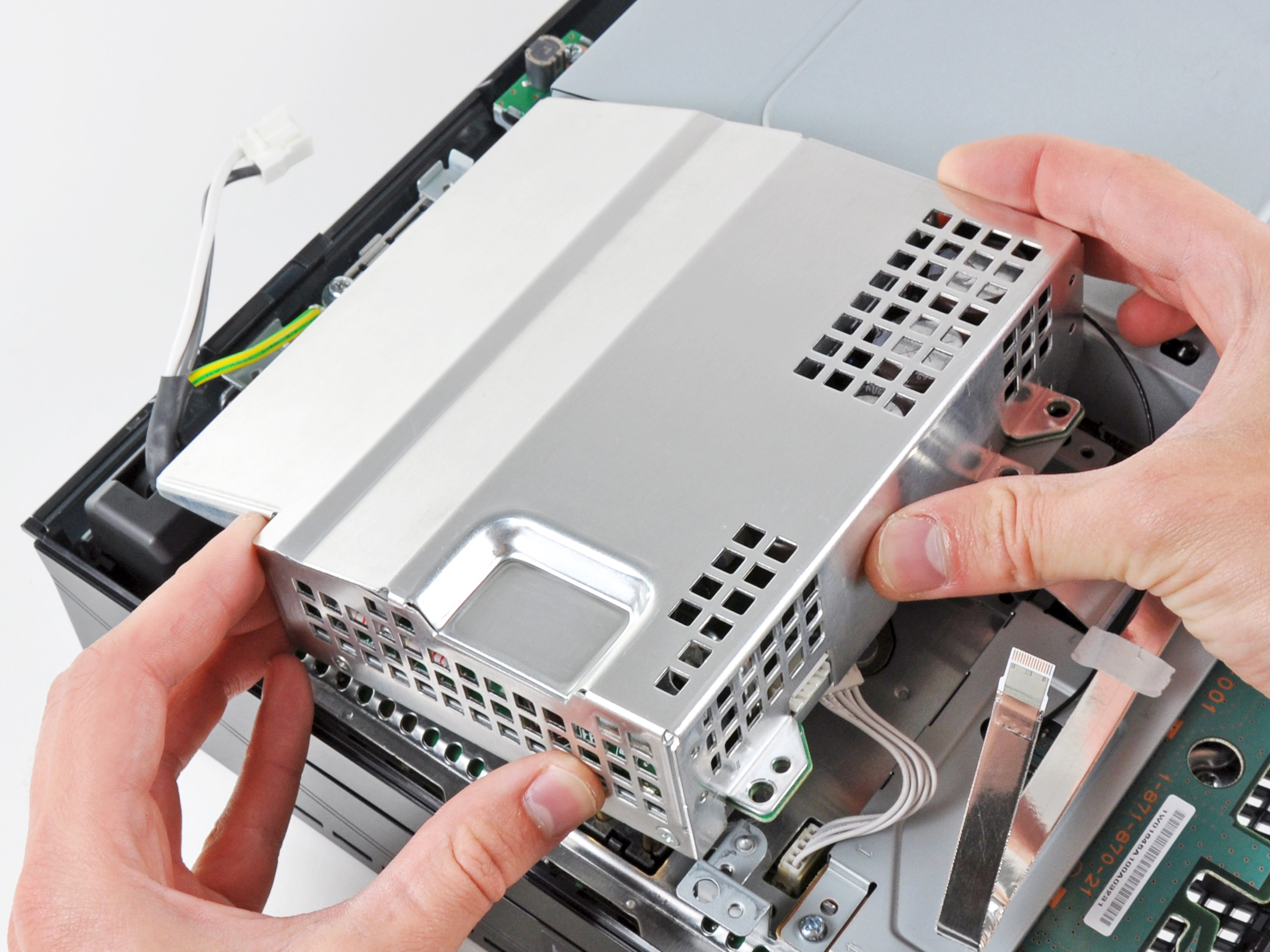

Use this guide to replace a broken power supply.
Image #1 Image #2
Add Note Edit Step 1 — Smart Plate  ¶
  • Use the tip of a spudger to remove the black rubber screw cover from the side of the PS3.
Image #1
Add Note Edit Step 2  ¶
  • Remove the single 8.5 mm T10 Security Torx screw from the smart plate.
Image #1 Image #2 Image #3
Add Note Edit Step 3  ¶
  • Pull the smart plate toward the hard drive bay, then lift it off the body of the PS3.
Image #1
Add Note Edit Step 4  ¶
  • Be sure to keep track of the small metal bracket loosely held in the top cover, if equipped.
Image #1
Add Note Edit Step 5 — Top Cover  ¶
  • Remove the following seven screws:
    • Six 52 mm Phillips screws
    • One 30 mm Phillips screw
Image #1
Add Note Edit Step 6  ¶
  • Lift the top cover from its rear edge and rotate it toward the front of the PS3.
  • Remove the top cover.
Image #1
Add Note Edit Step 7 — Memory Card Reader  ¶
  • Remove the two 9 mm Phillips screws securing the memory card reader to the chassis.
Image #1 Image #2
Add Note Edit Step 8  ¶
  • Lift the memory card reader out of the PS3 enough to access its cable.
  • Flip up the retaining flap on the memory card reader ribbon cable socket.
  • Be sure you are prying up on the retaining flap, not the socket itself.
  • Pull the ribbon cable out of its socket.
  • Remove the memory card reader from the PS3.
