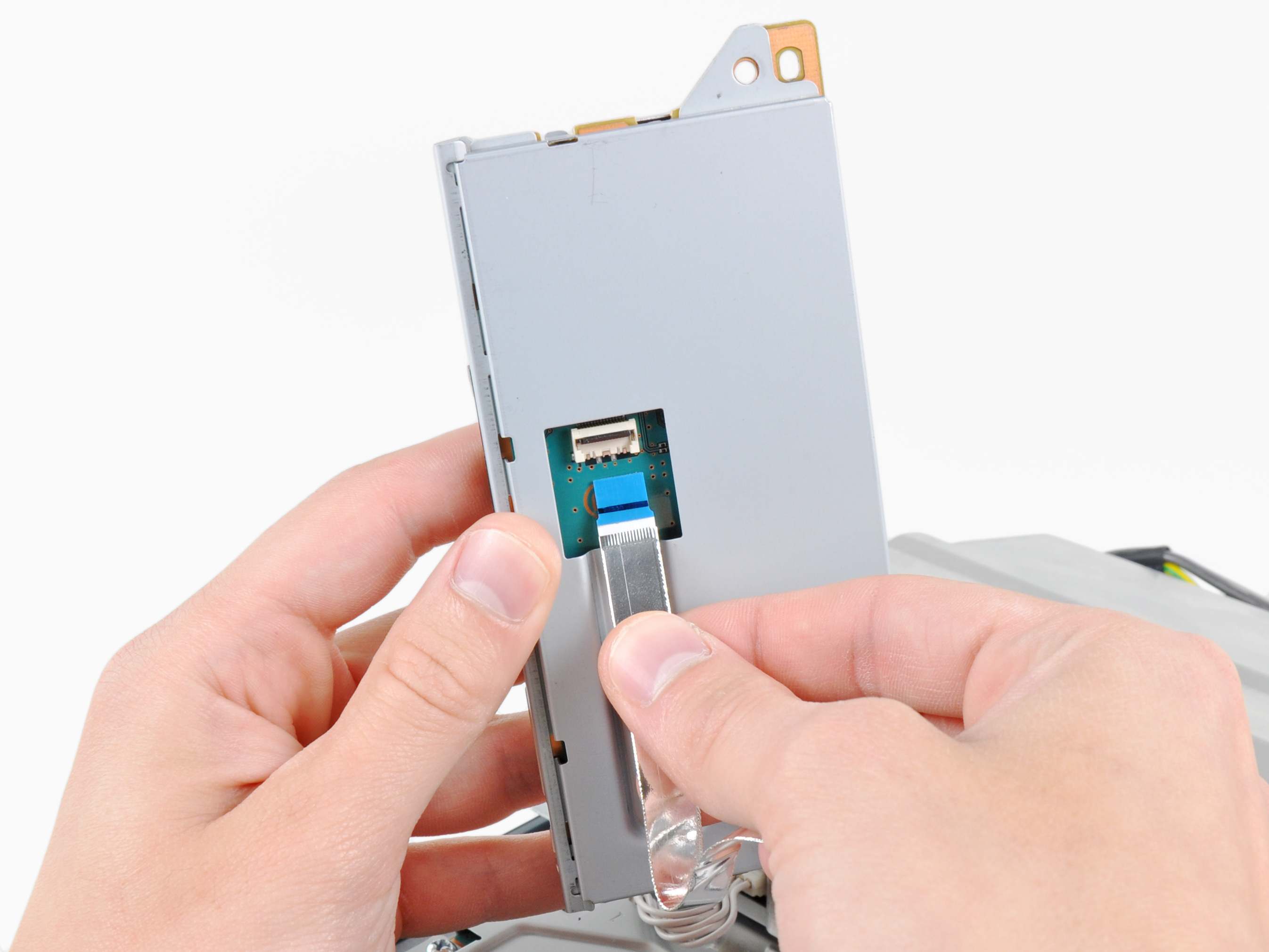

Add Note Edit Step 7 — Memory Card Reader  ¶
  • Remove the two 9 mm Phillips screws securing the memory card reader to the chassis.
Image #1 Image #2
Add Note Edit Step 8  ¶
  • Lift the memory card reader out of the PS3 enough to access its cable.
  • Flip up the retaining flap on the memory card reader ribbon cable socket.
  • Be sure you are prying up on the retaining flap, not the socket itself.
  • Pull the ribbon cable out of its socket.
  • Remove the memory card reader from the PS3.
