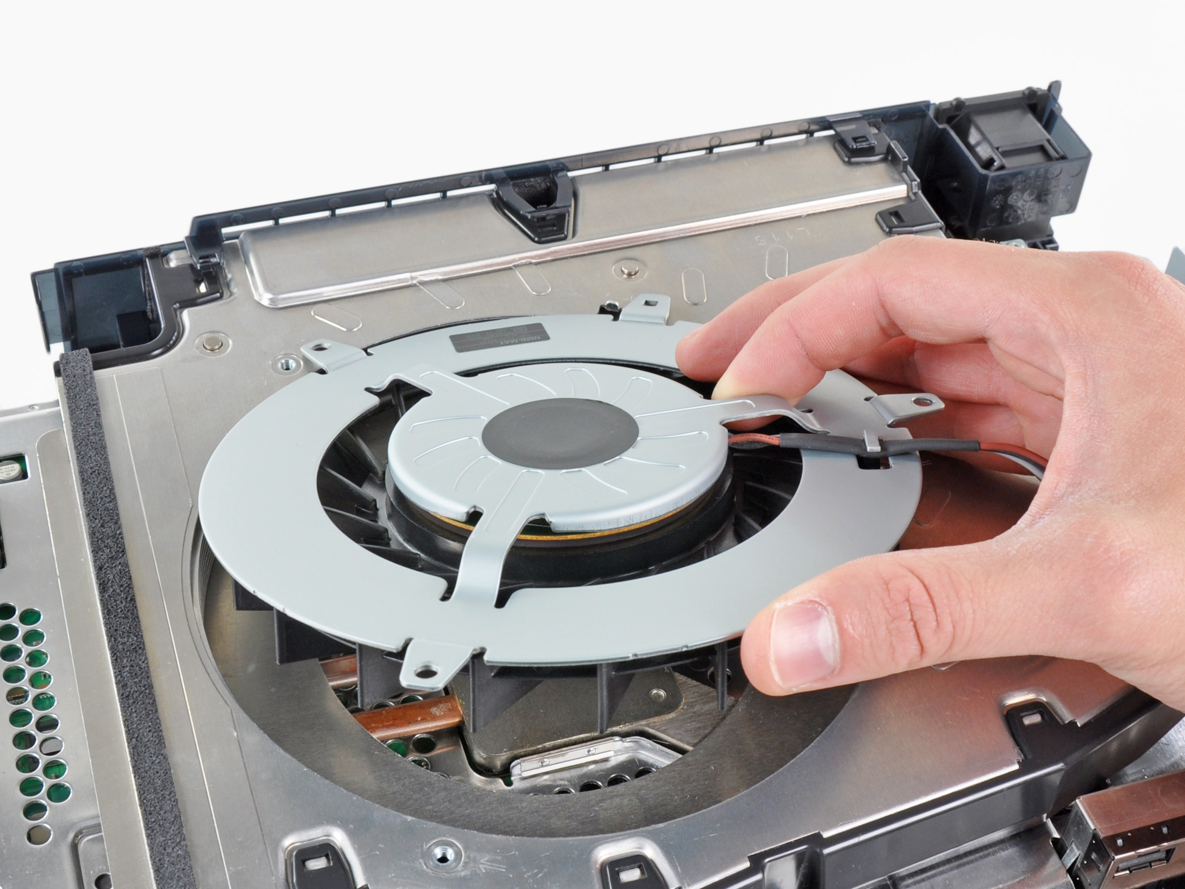

Use this guide to replace a burned-out fan on your PlayStation 3.
Use the tip of a spudger to remove the black rubber screw cover from the side of the PS3.
Remove the following seven screws:
Six 52 mm Phillips screws
One 30 mm Phillips screw
Lift the top cover from its rear edge and rotate it toward the front of the PS3.
Remove the top cover.
There is a plastic hook located in a hole on the top back right hand side corner. Carefully push the plastic hook a bit from the rear of the machine with a spudger to release the rear right of the casing.
Pull the control board ribbon cable straight up and out of its socket on the motherboard.
