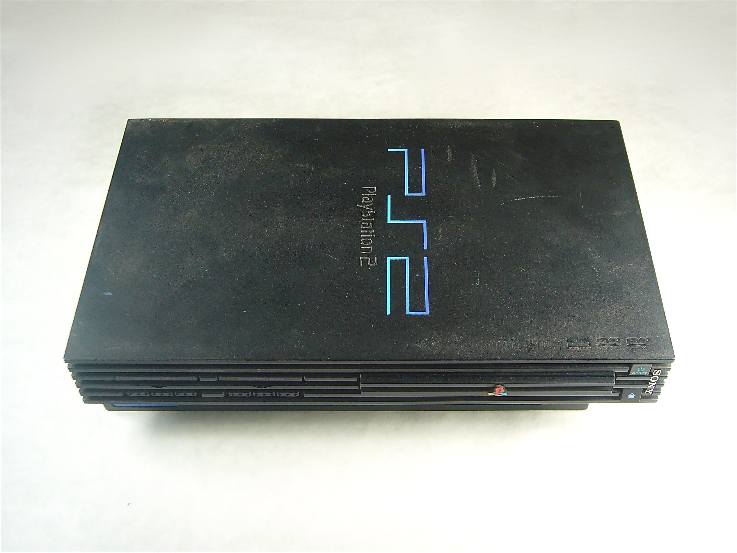

  • Flip the PlayStation 2 over so it lays with the bottom of the device facing upwards.
  • Use the flat edge of a metal spudger to pry the eight flat screw covers out.
  • Remove the following eight screws securing the top cover to the bottom case:
    • Four 55.4 mm Philips screws
    • Four 18.0 mm Phillips screws
Image #1
Add Note Edit Step 2  ¶
  • Peel the warranty sticker (located next to the main power switch) straight away from the case.
  • To avoid activating the VOID that may come up, heat it carefully to remove and replace it clean
Image #1 Image #2
Add Note Edit Step 3  ¶
  • Flip the PlayStation 2 back to its original upside position.
  • Lift the top cover off the bottom case.
  • To facilitate the removal, it is recommended to pry open the half closer to the power switch first while rocking the top cover towards the front of the bottom case.
  • Carefully remove the power cord that attaches the top and bottom halves by disconnecting the power cord assembly from the bottom case.
