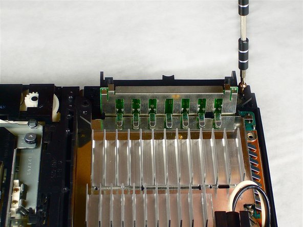

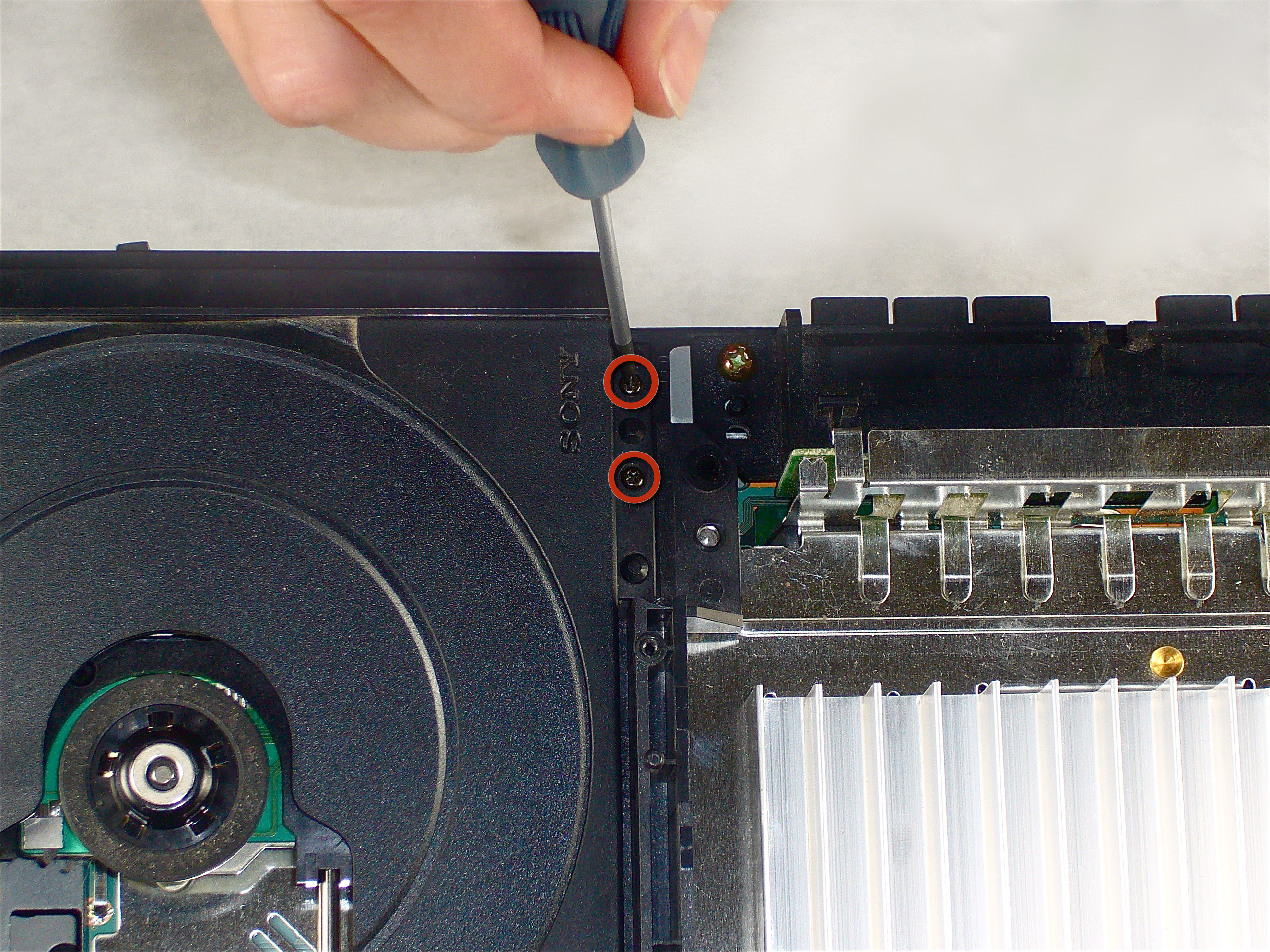

Add Note Edit Step 4 — Power Board  ¶
  • Remove the two 6.4 mm black Phillips screws securing the optical disc drive to the bottom case.
  • Lift and remove the optical disc drive straight up out of the bottom case.
Image #1 Image #2

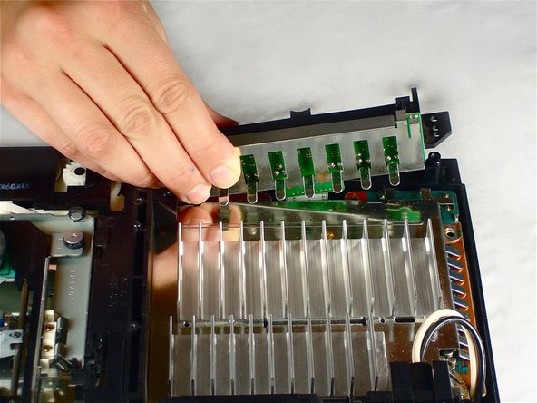

Add Note Edit Step 5  ¶
  • Remove the two 14.6 mm gold-headed Phillips securing the controller ports to the bottom case.
Image #1 Image #2
Add Note Edit Step 6  ¶
  • Gently lift the controller port board out of its recess within the bottom case.
  • Do not completely remove the controller port board. It is still attached via a ribbon cable.
  • Pull the controller port ribbon cable straight away from its socket on the controller port board.
  • Remove the controller port board out of the bottom case.
