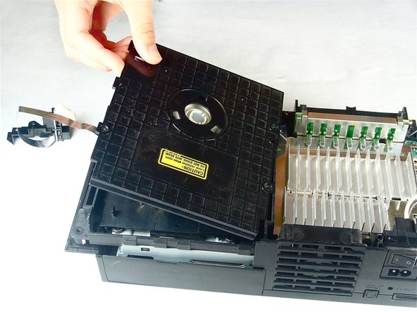

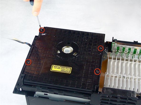

Add Note Edit Step 4 — Optical Disc Drive Laser Assembly  ¶
  • Remove the four 6.4 mm Phillips screws securing the top lid of the optical disc drive.
  • Lift and remove the lid from the optical disc drive.
