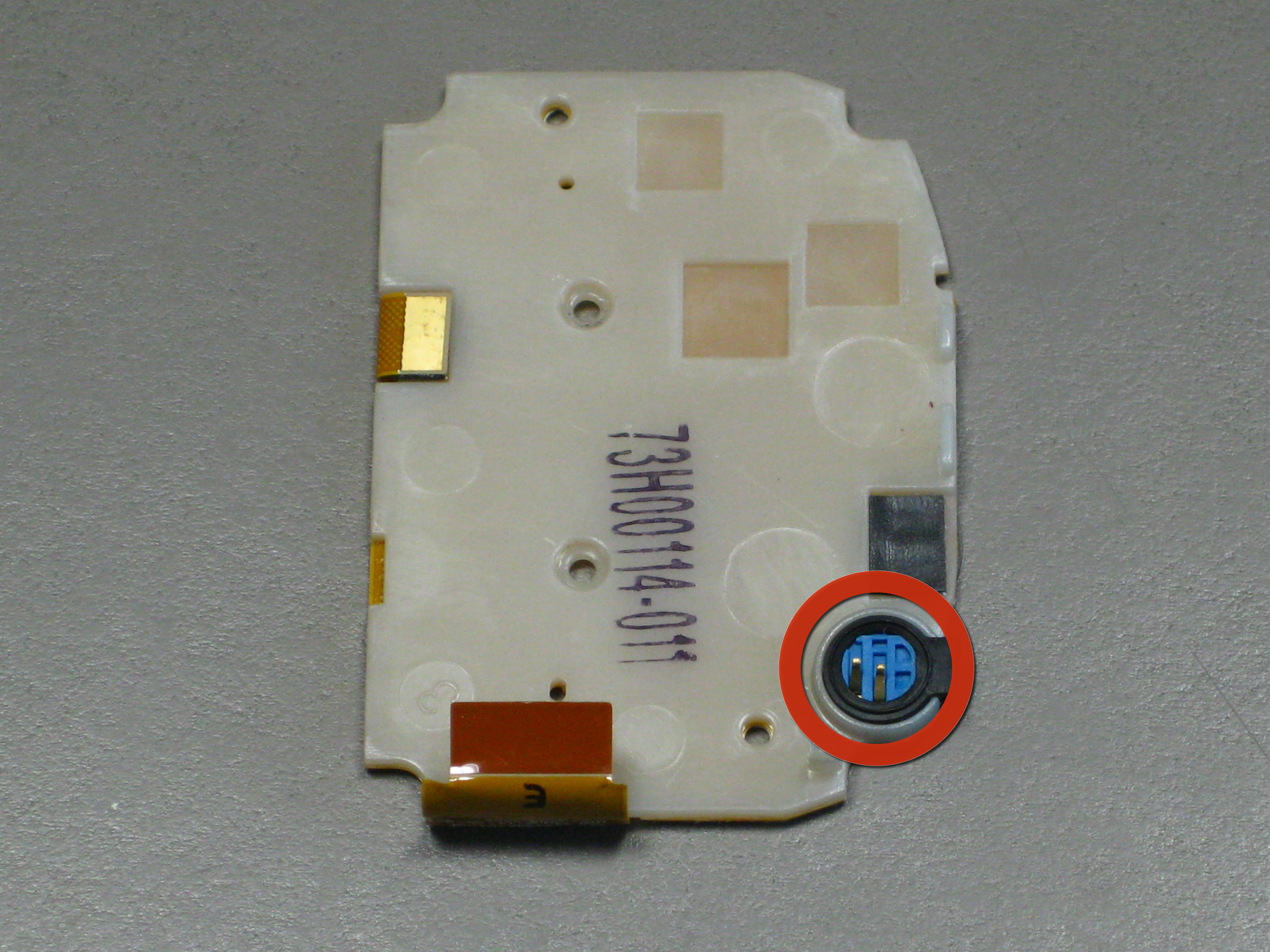

A guide for removing and replacing the phone's microphone.

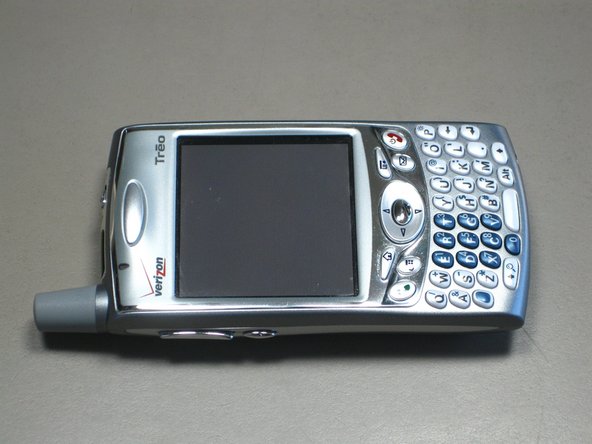

  • Place your Palm Treo 650 on a table in front of you as shown.
Image #1
Add Note Edit Step 2  ¶

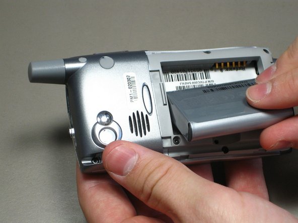

Add Note Edit Step 4  ¶
  • Lift the edge of the battery as pictured and pull out.

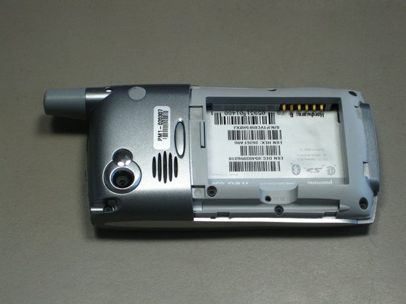

Add Note Edit Step 6  ¶
  • Unscrew six 6.9 mm black screws with a T5 Star screwdriver.
  • Unscrew one 9.75 mm antenna screw with a T5 Star screwdriver.
  • Pull out antenna.
Image #1 Image #2

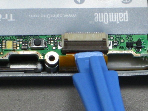

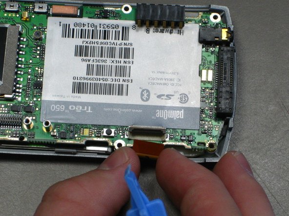

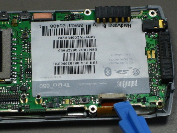

Add Note Edit Step 8 — Motherboard  ¶
  • Unclip the gray tab.
  • Pull out the orange ribbon cable.
  • Be careful not to remove the motherboard before disconnecting the ribbon cable so it isn't damaged.
