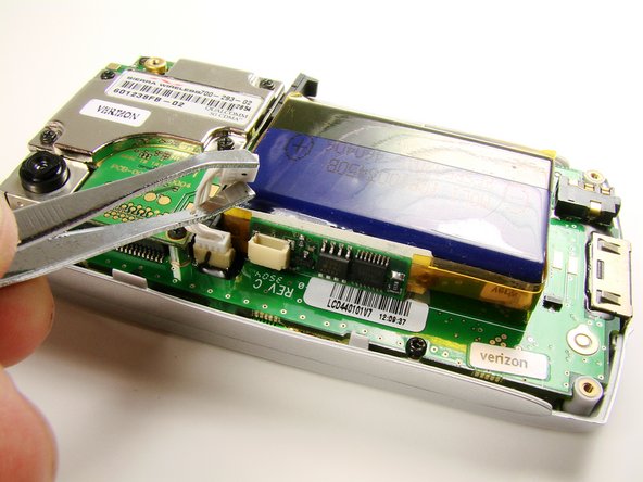

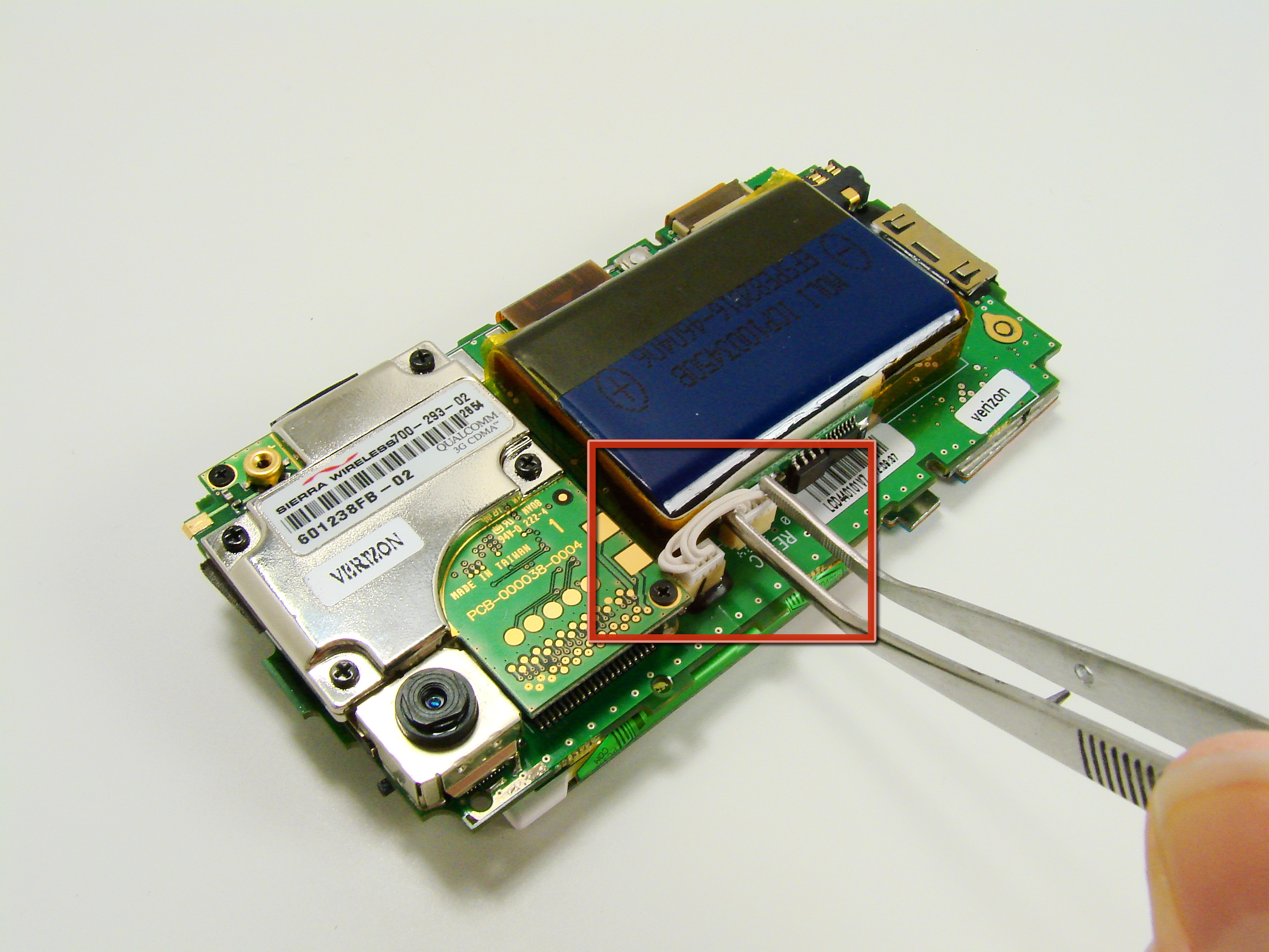

Add Note Edit Step 4 — Battery  ¶
  • Using metal tweezers, unplug small white plug.
  • Pulling the white plug will disconnect the battery. Make sure the phone is off before you do this step.
Image #1
Add Note Edit Step 5  ¶
  • Slide the flat side of the spudger under the battery and gently dislodge the battery by lifting the spudger up.
  • The battery may be glued to the phone.
