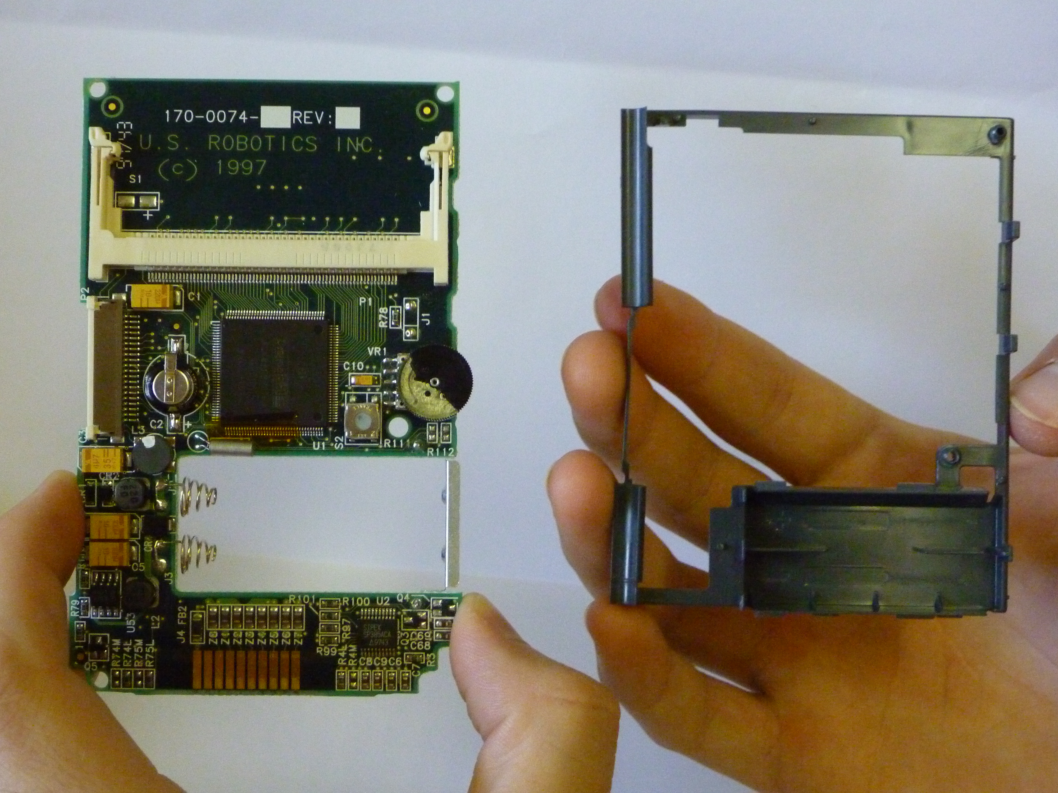

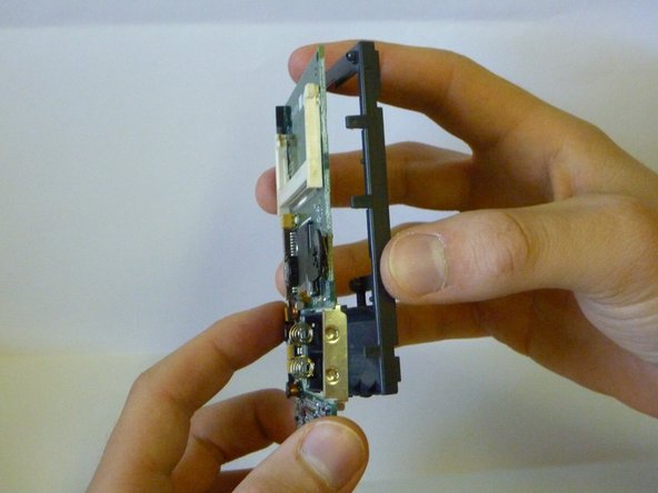

  • Pull/push the battery casing through the rectangular opening. The mother board should now separate from the plastic frame.
  • Note: The frame might have to be wiggled towards the left (when the springs are facing left) to become fully released.
