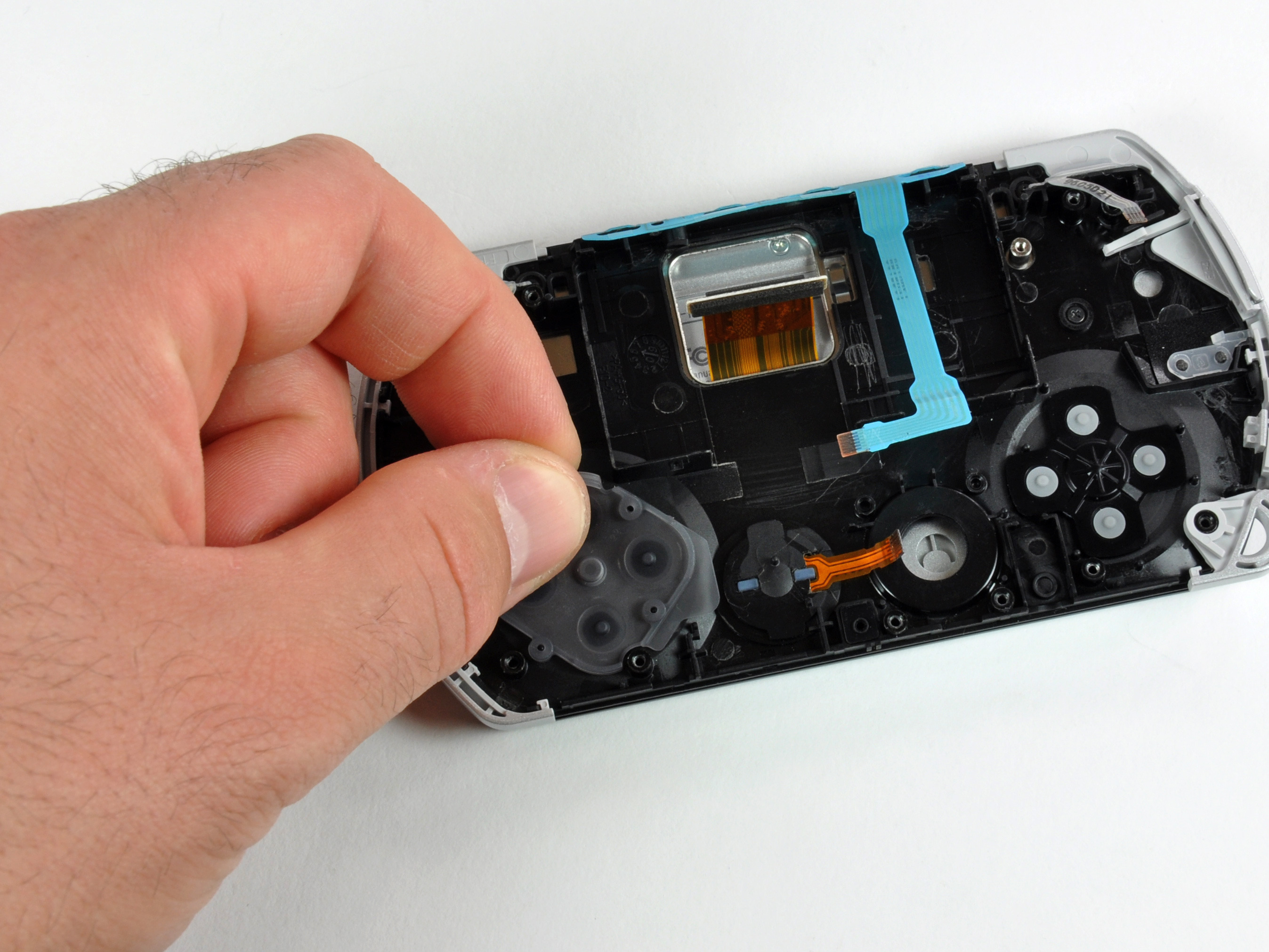

Add Note Edit Step 17 — Gamepad Buttons  ¶
  • Lift the gamepad buttons out of the PSP Go.
For more information, check out the PSP Go device page.
