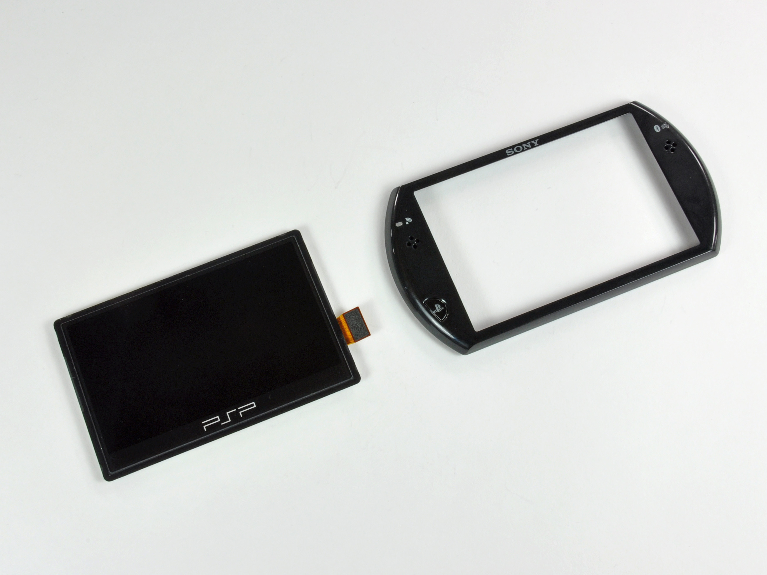

Installing PSP Go Front Panel
- Author: Miroslav Djuric
- Time required: 1 hour
- Difficulty: Difficult
Use this guide to replace the PSP Go's front panel!
Sections
- Back Cover 2 steps
- Top Cover 1 step
- Left Trigger 2 steps
- Battery 3 steps
- Logic Board 8 steps
- Display 5 steps
- Front Panel 1 step
