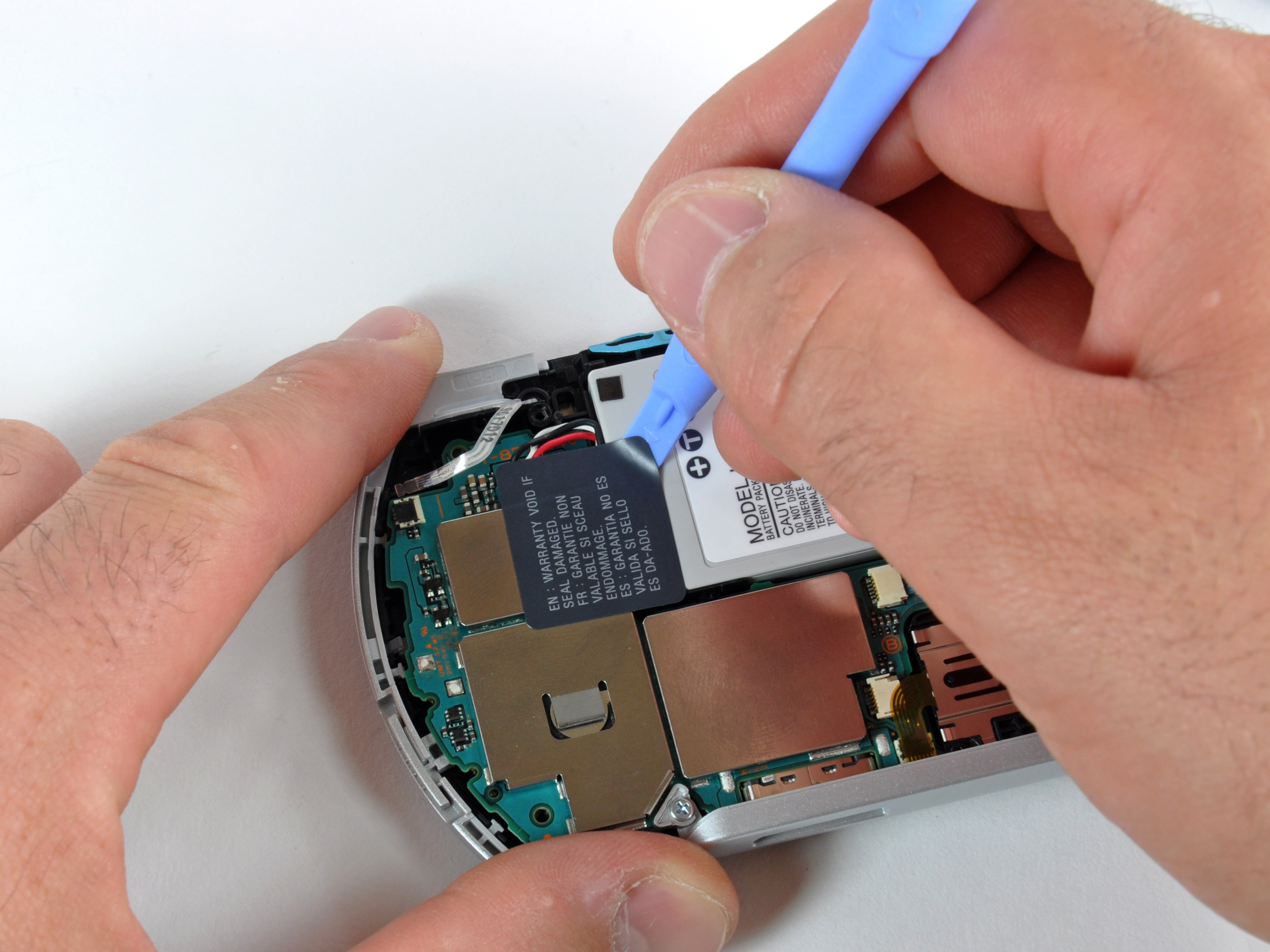

Add Note Edit Step 6 — Battery  ¶
  • Do not peel the sticker away from the left EMI shield. It will expose the "VOID VOID" lettering that will void your warranty!
  • Use the plastic opening tool to gently peel away at the "Warranty Void" sticker. Start on one edge, as shown, and slide the tool from side to side until the sticker is removed from just the battery.
Image #1
Add Note Edit Step 7  ¶
  • Gently pull the sticker away from the battery connector, just enough so that the connector is visible.
  • Wedge a plastic opening tool in between the connector and logic board, and gently pull the connector upwards.
  • Make sure not to disconnect the white connector socket on the logic board, and just the connector itself.
Image #1 Image #2
Add Note Edit Step 8  ¶
  • Use a plastic opening tool to pop out the battery, being careful not to snag the "Warranty Void" sticker in the process.
  • When putting a new battery into the PSP Go, make sure you hold the "Warranty Sticker" so you don't put the battery on top of it.
