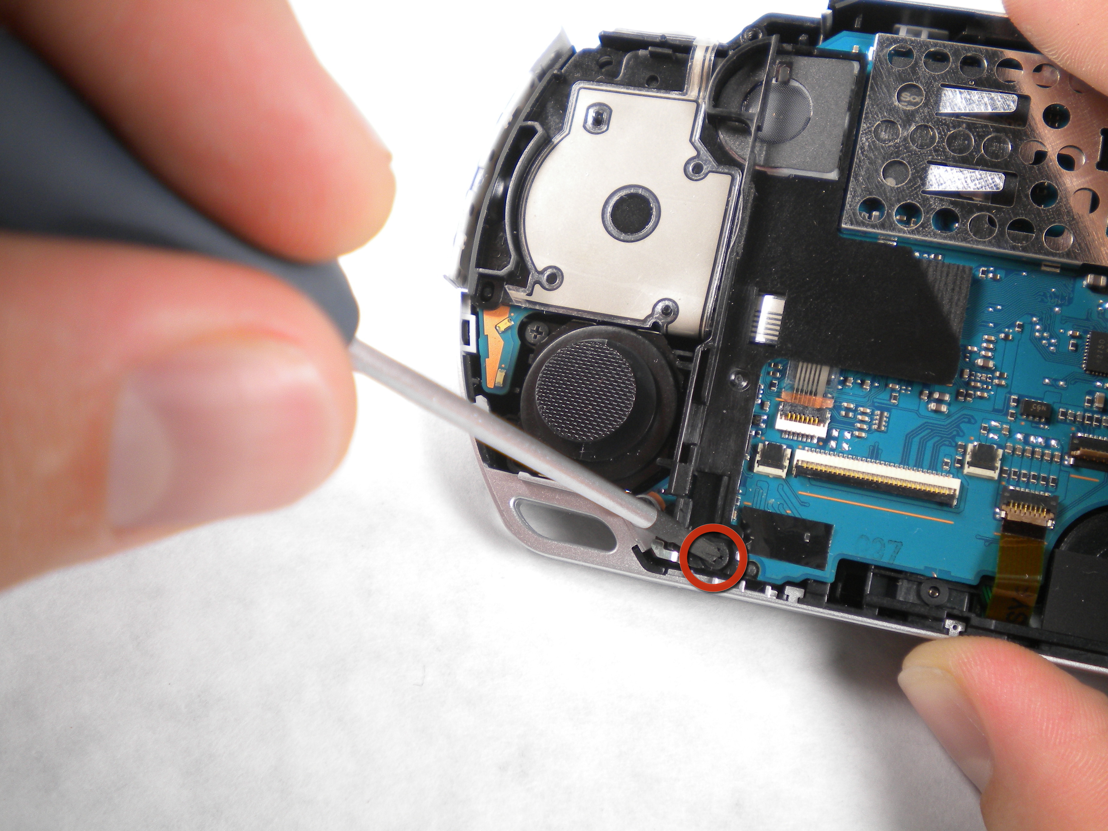

  • Starting from the 'R' shoulder button, slide the spudger in between the outer casing of the PSP, and gently pry off the casing.
  • Remove the front casing completely.
Image #1
Add Note Edit Step 8 — LCD Screen  ¶
  • Push the homebar to the right to release the tab on the right side of the LCD screen.
  • DO NOT completely remove the homebar, as it is still connected by ribbon cables.
