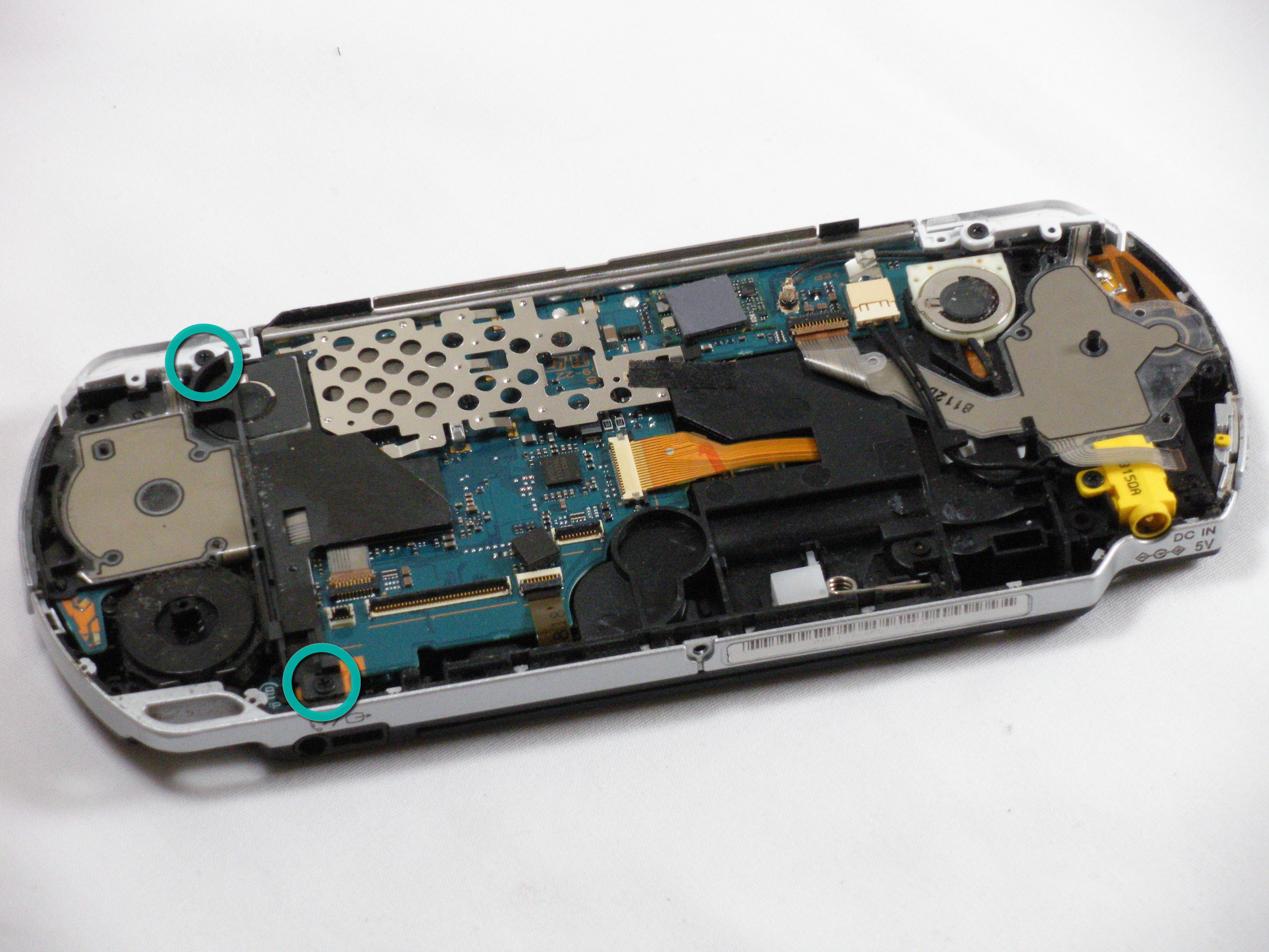

Add Note Edit Step 8 — Memory Stick Slot  ¶
  • Remove two 4.5 mm Phillips screws from the left-hand side of the PSP.
  • Slide off the left trigger along with the plastic bracket underneath.
  • Carefully pry off left trigger button using opening tools.
  • The button is adhered to the body. It can be re-adhered with hot glue after being pried-up, if necessary.
