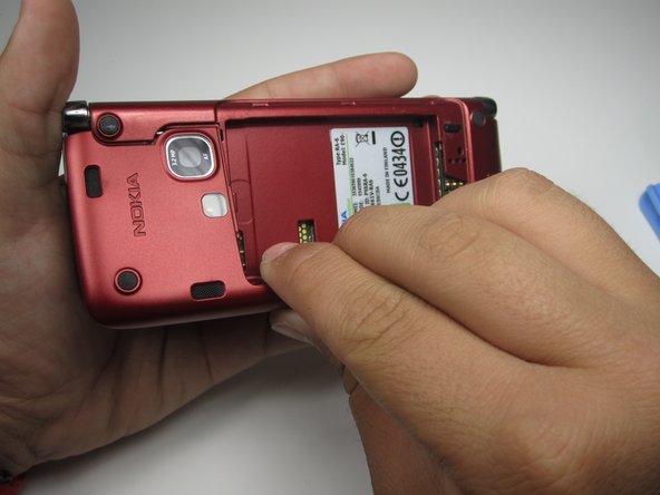

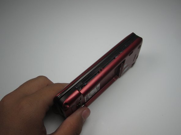

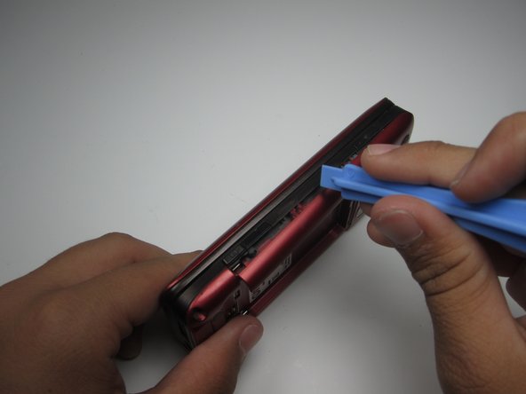

  • Using a plastic opening tool, separate the back cover from the phone.

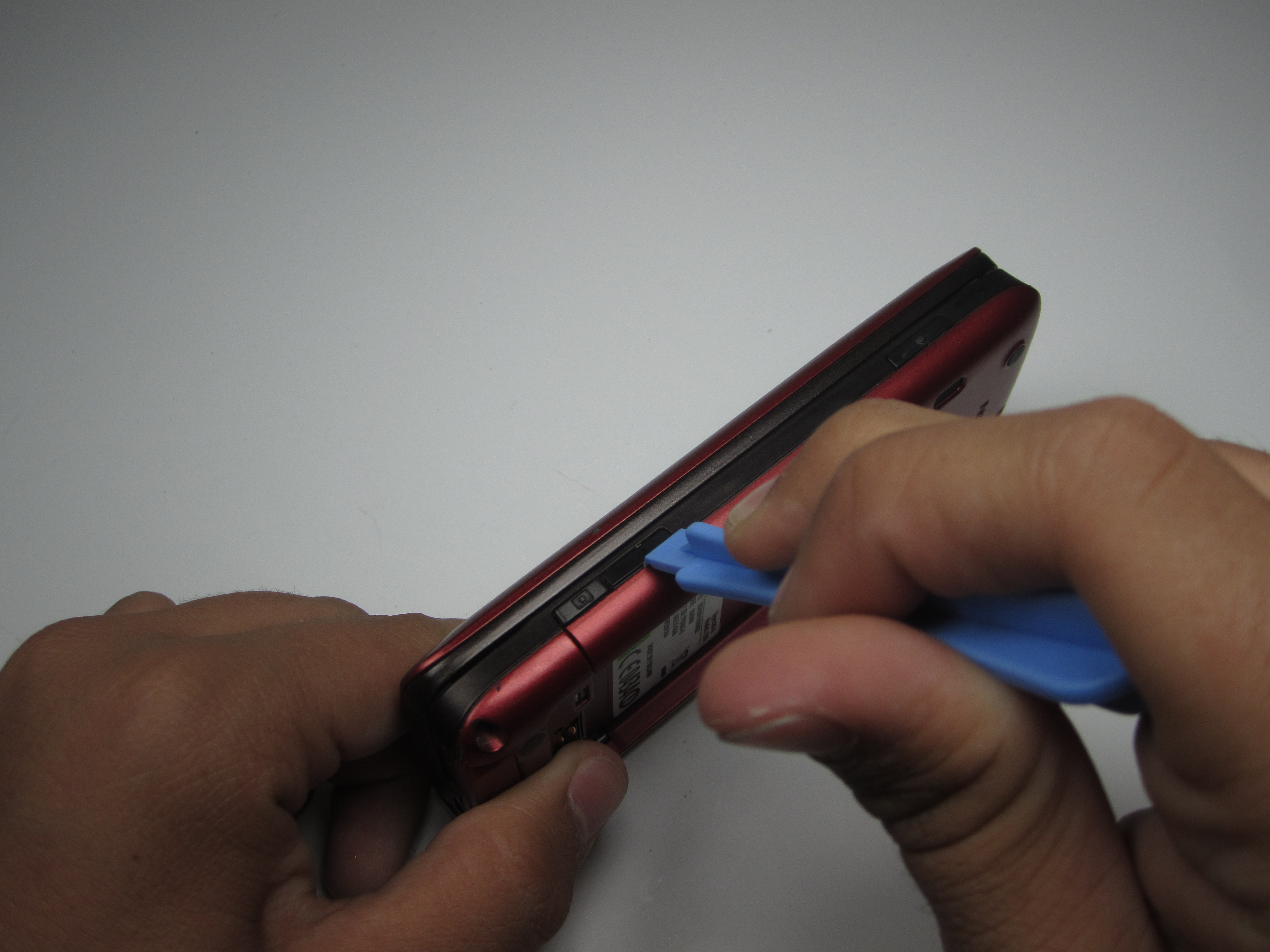

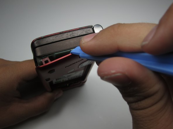

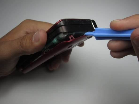

Add Note Edit Step 2  ¶
  • Continue along the edge with the plastic opening tool.

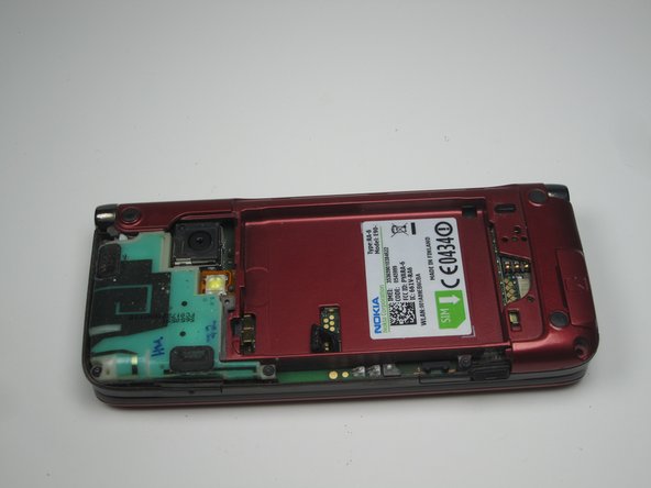

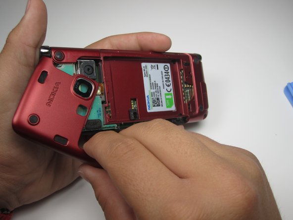

Add Note Edit Step 3  ¶
  • Gently, remove the back cover.
