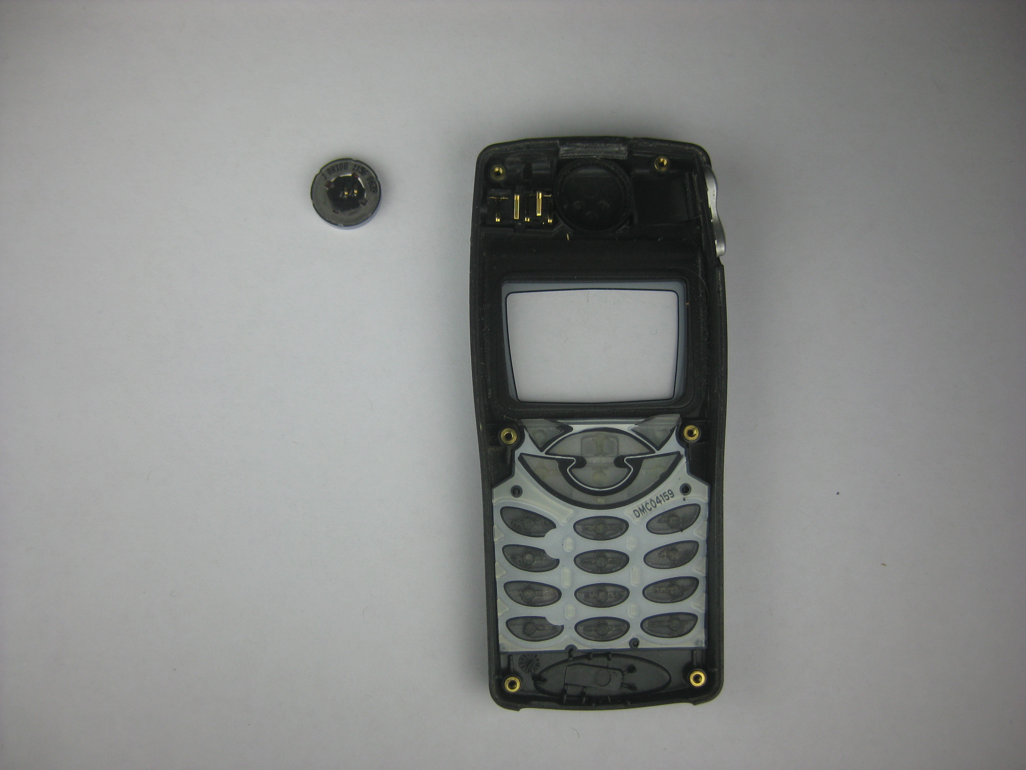

How to remove the speaker.

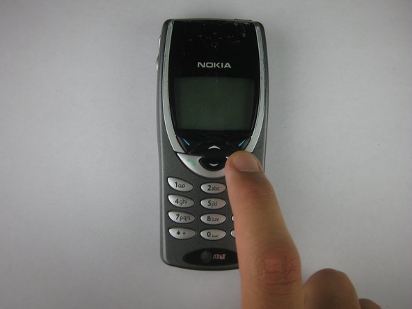

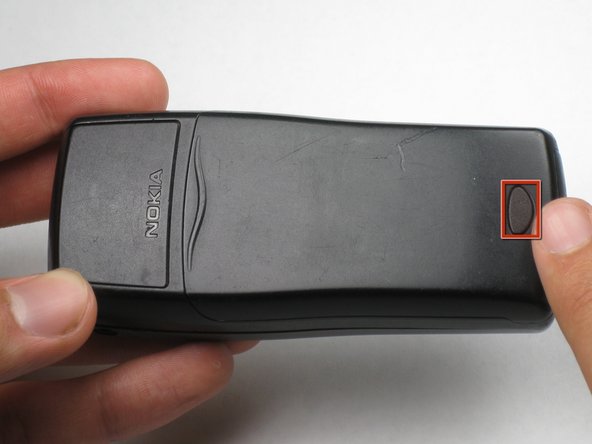

  • Turn off the cell phone.
Image #1
Add Note Edit Step 2  ¶

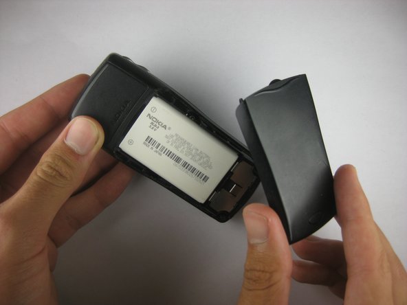

  • Press down on the round button on the back cover of the phone.
Image #1
Add Note Edit Step 3  ¶

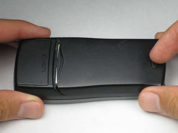

  • Slide the back cover down while still pressing the button.
Image #1
Add Note Edit Step 4  ¶
  • Remove the back cover.

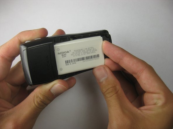

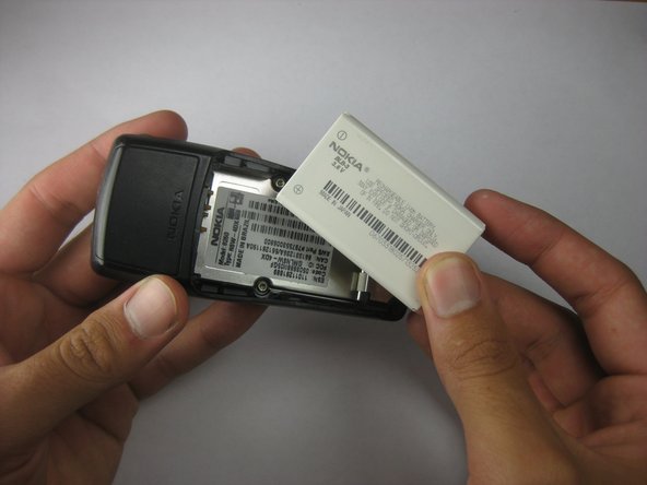

  • Press the end of the battery towards the top of the phone.
Image #1
Add Note Edit Step 6  ¶
  • Lift the battery outwards while still pressing it upwards till it pops out.
  • You may need to take several attempts to lift out the battery.

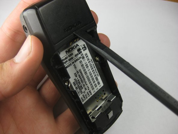

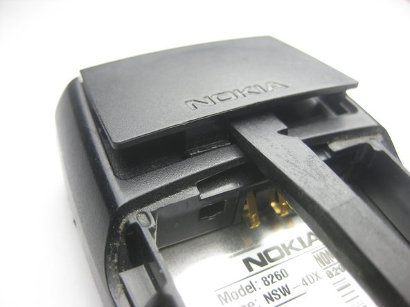

Add Note Edit Step 7 — Antenna  ¶
  • Squeeze the flat end of the spudger into the crack right under the word "Nokia" on the back of the phone.
  • This step may be a bit difficult if you are removing the antenna for the first time.
Image #1
Add Note Edit Step 8  ¶
  • Pry open the antenna door by pulling down the top of the spudger
