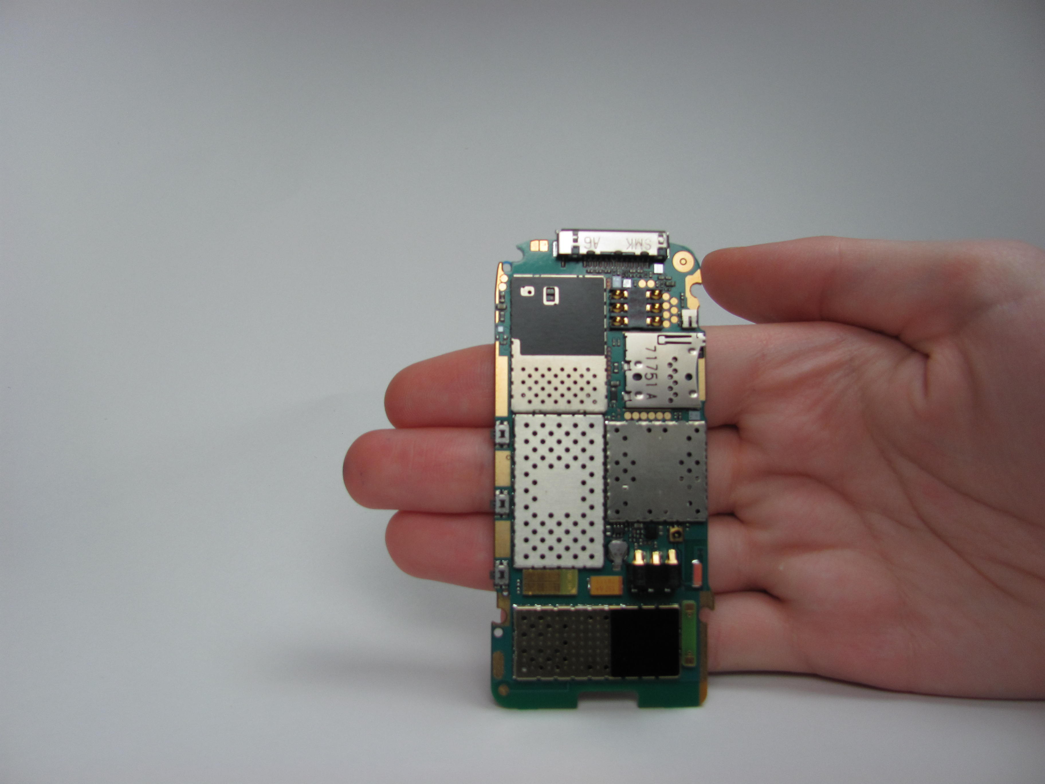

Replacing the PCB or logic board of the phone.

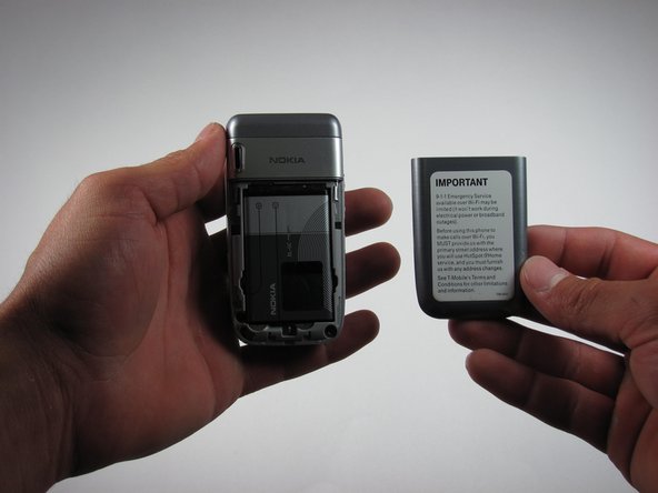

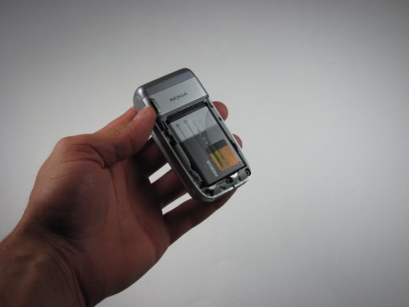

  • Remove the back battery cover.
    • Apply pressure on the cover while simultaneously sliding the cover downward.

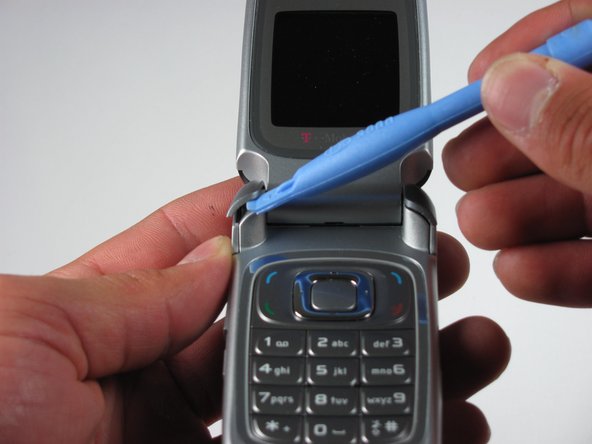

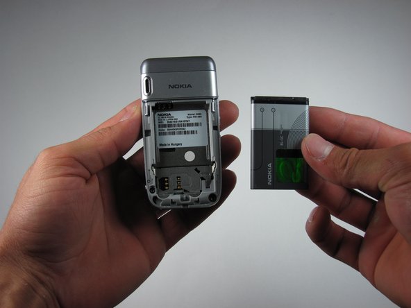

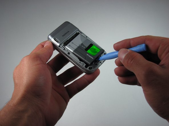

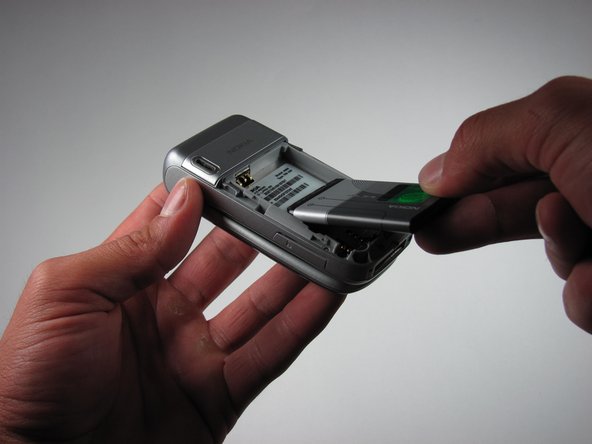

  • Insert the iPod opening tool between the base of the phone and the phone battery.
  • Position the phone so that the battery won't fall out of the phone.
    • The battery lifts out of the phone fast and easily.
  • Carefully lift the battery out of the phone.

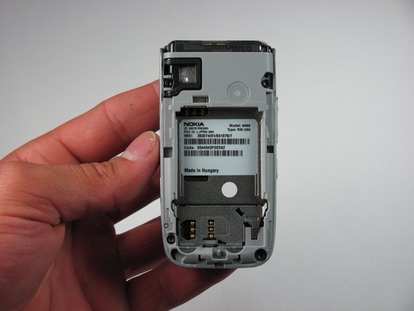

Add Note Edit Step 4 — Upper Back Cover  ¶

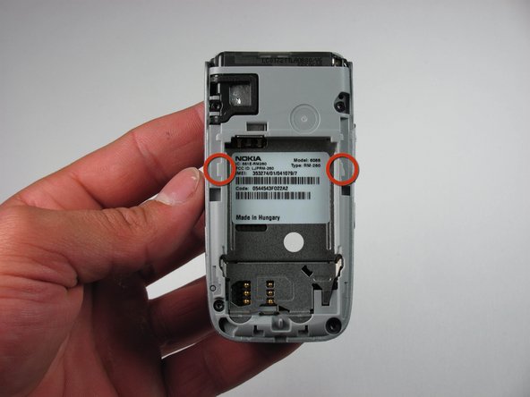

  • Turn the phone so that the back of the phone is facing forward.
  • The picture to the left shows the location of the plastic tabs that attach to the upper cover of the phone.
    • In this picture, the upper cover has already been removed.
Image #1 Image #2

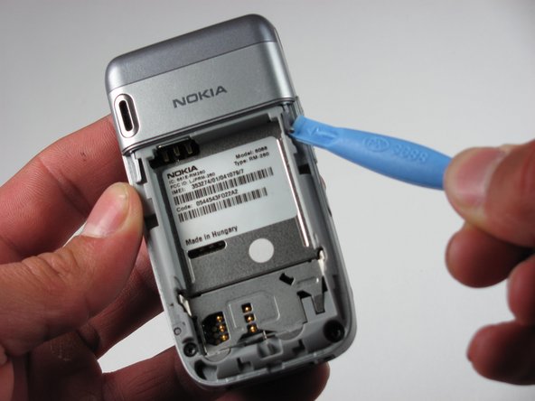

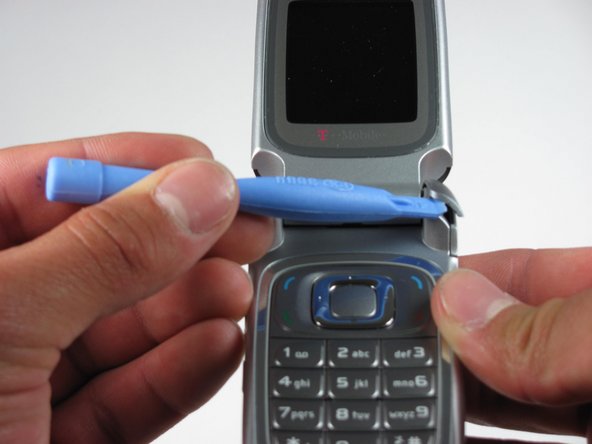

  • Place the iPod opening tool under the tabs near the top of the phone.
  • Slide the iPod Opening Tool upwards.
    • This will pop the tabs and release the upper part of the phone.
  • Repeat for the left and the right sides.

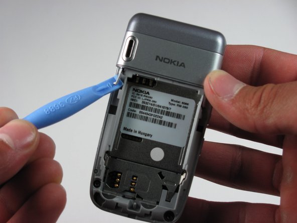

  • Place the iPod opening tool at the top area of the bottom section of the phone (indicated in picture).
  • Lift the iPod opening tool to pop open the clips.
    • This will release the upper back cover of the phone.

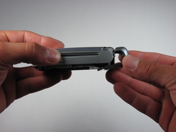

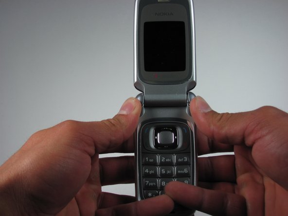

  • Push upward on the top back cover using two thumbs.
    • This will remove the top back cover from the phone.

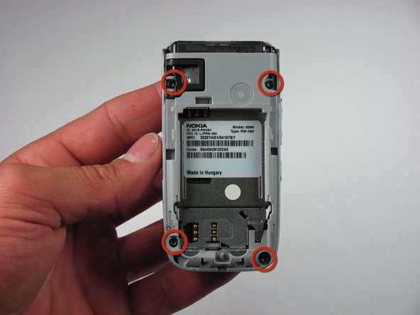

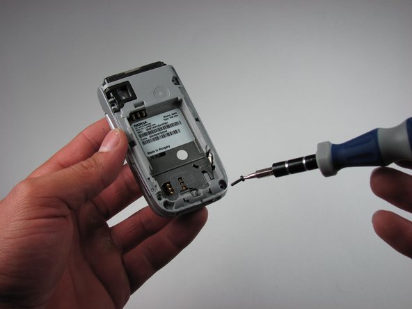

  • Locate the four screws.
  • Remove the screws using a T6 Torx screwdriver.
