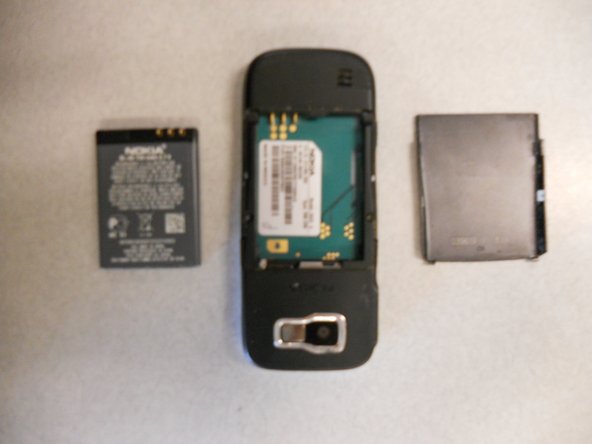

Add Note Edit Step 1 — Battery Case  ¶

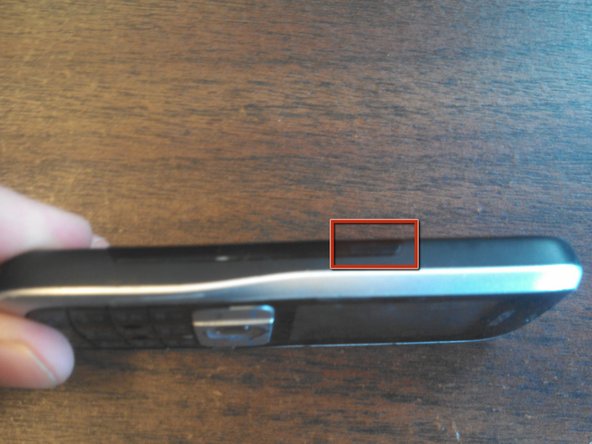

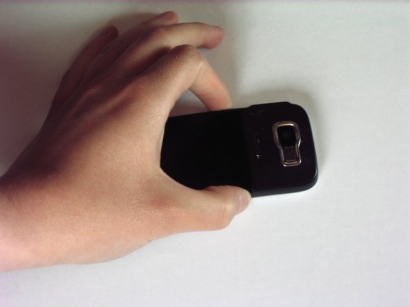

  • Press the release buttons located on either side of the battery cover
  • Pull the battery cover away from the phone

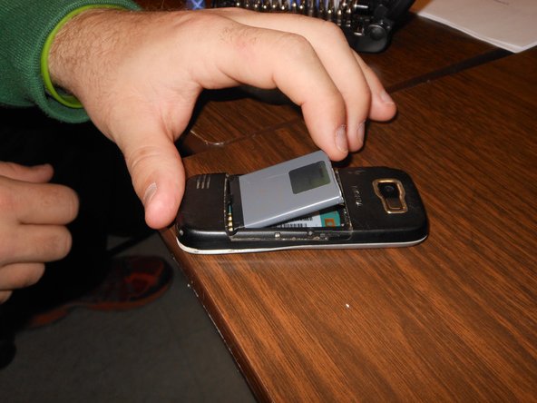

Add Note Edit Step 2  ¶
  • Gently pull the battery out of the phone with your fingers

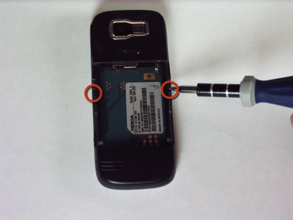

  • Remove the two screws on either side of the battery case using the microscrewdriver using the T5 bit
    • The T5 bit has a star shaped end and has "T5" engraved on the side of the bit for easy identification
  • NOTE: Keep the screws in a safe place while you continue working.

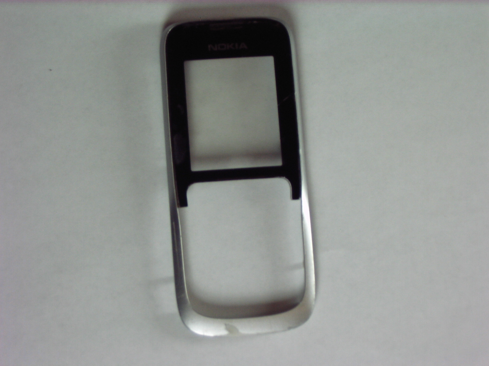

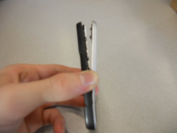

Add Note Edit Step 4  ¶

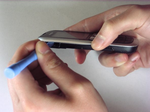

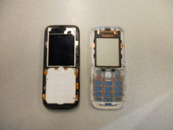

  • Separate the front case from the back case using the iPod opener
  • NOTE: The keypad is a loose piece and may fall out

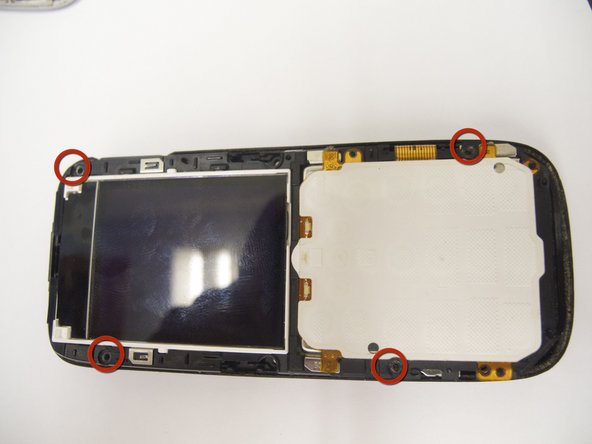

Add Note Edit Step 5  ¶
  • Remove screws using the same T5 screw bit to release the computer chip from the case

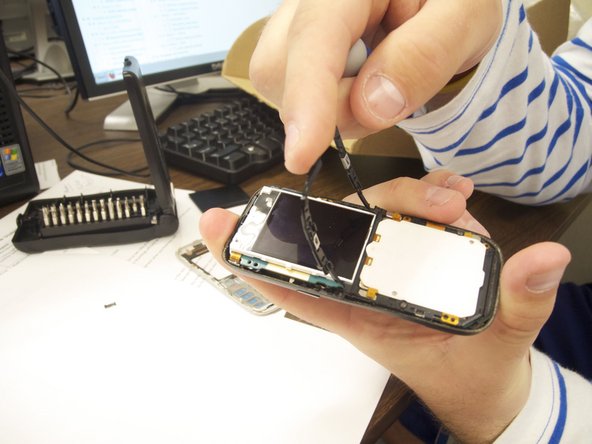

Add Note Edit Step 6  ¶
  • Carefully lift the black frame off the screen with your fingers
Image #1

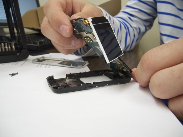

  • Carefully remove the computer chip and screen out of the black case with your fingers
Image #1 Image #2

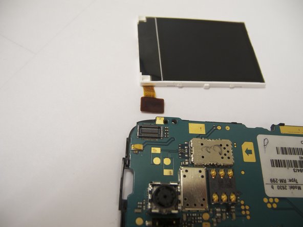

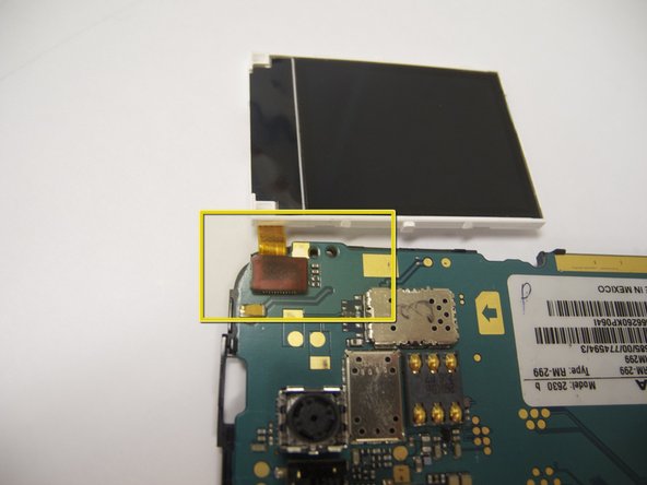

Add Note Edit Step 8  ¶
  • The screen is attached to the computer chip by an orange ribbon
  • Carefully detach the ribbon from the computer chip using your fingers
