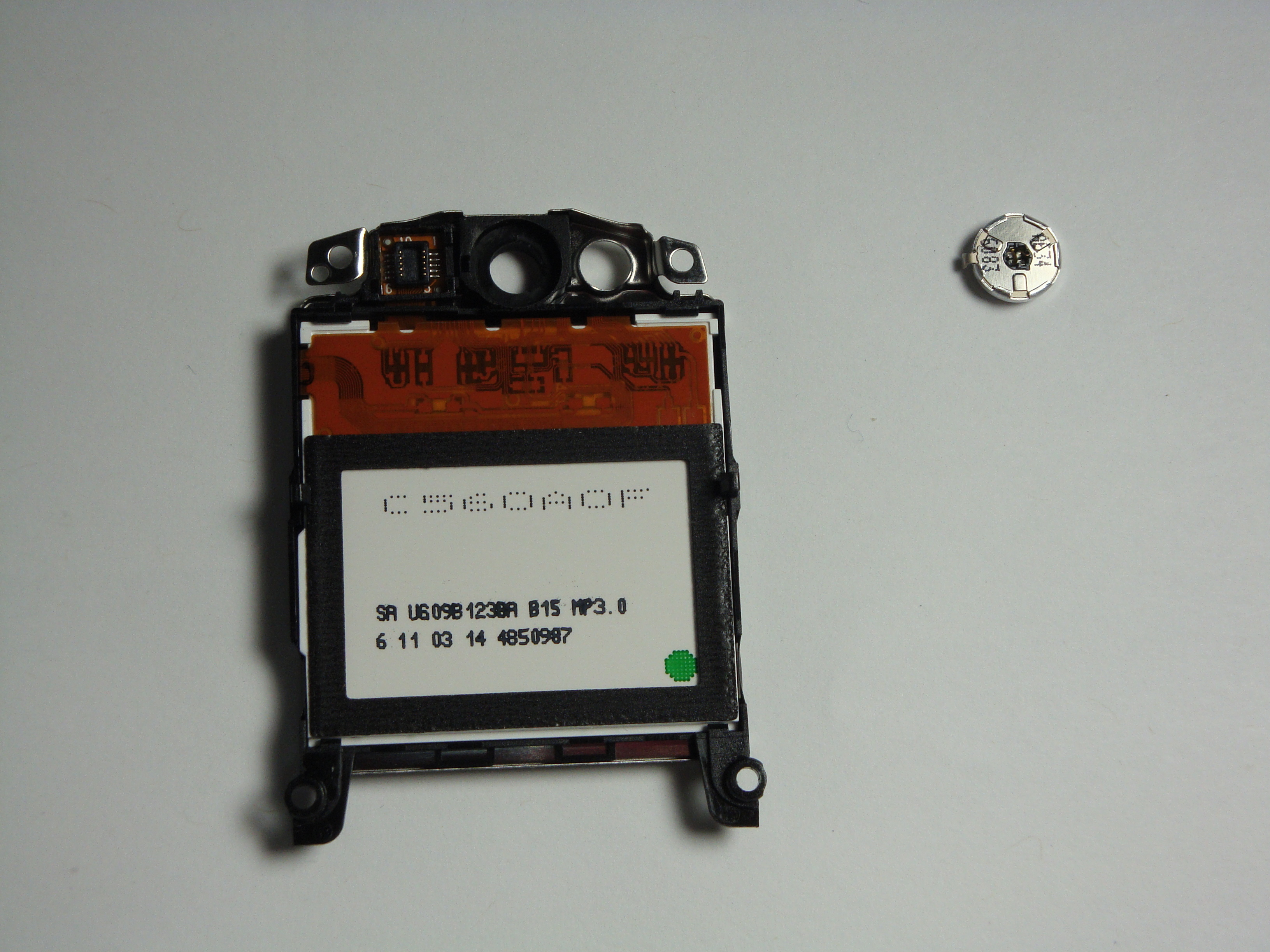

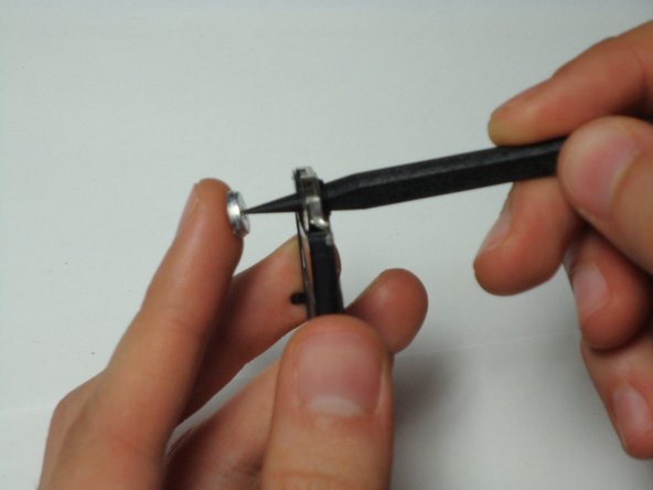

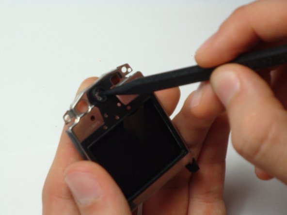

Add Note Edit Step 6 — Speaker  ¶
  • With the LCD unit removed, gently press out the speaker with a non-metallic pointed object.
