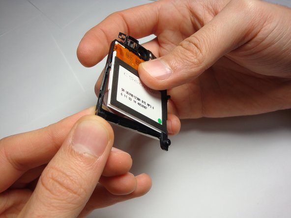

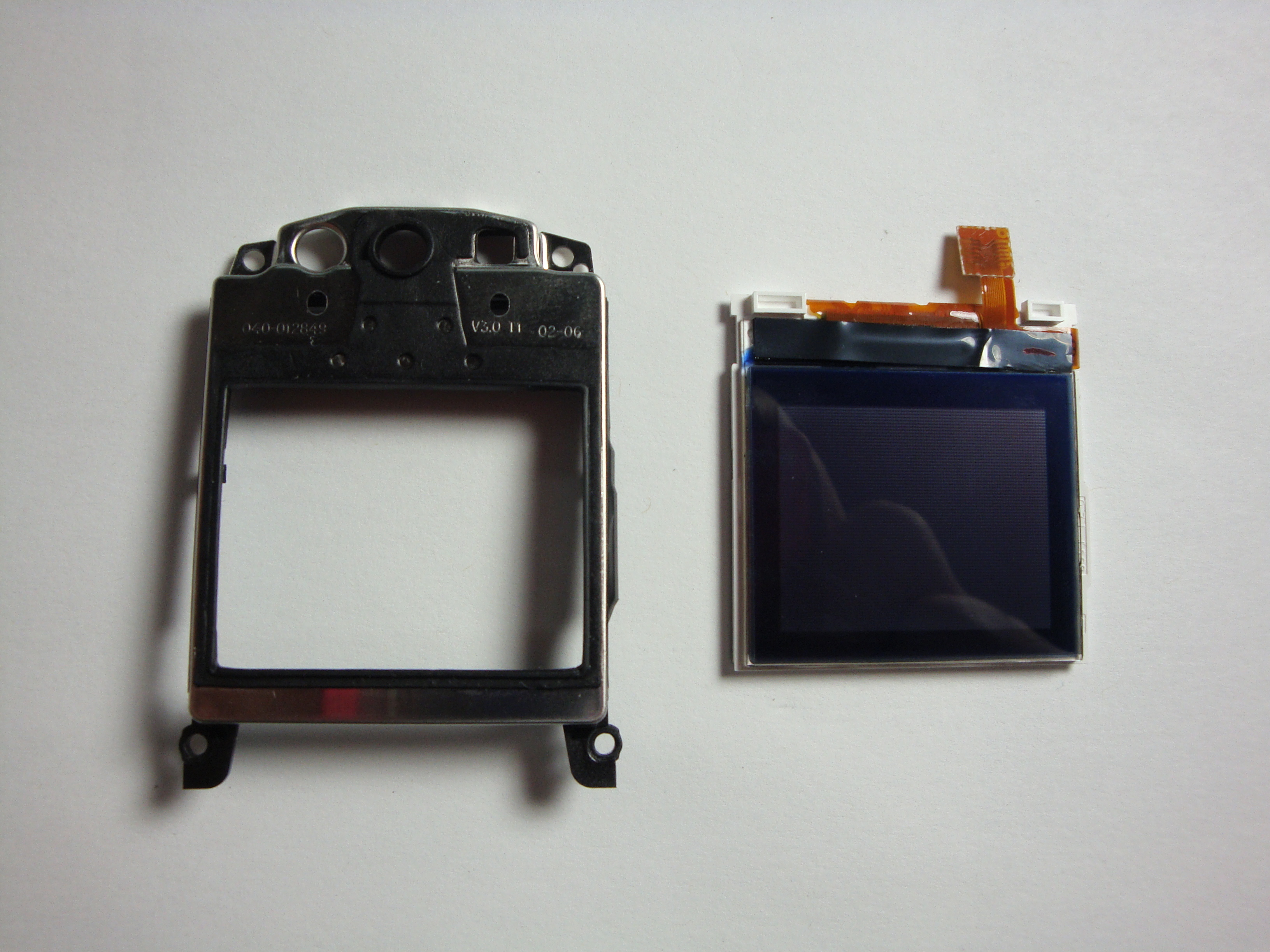

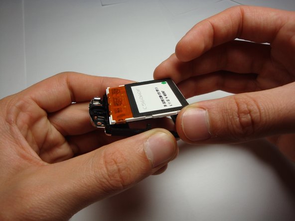

Add Note Edit Step 8 — LCD Screen  ¶
  • Pull one of the bottom corners of the rubber casing outward and detach LCD screen.
