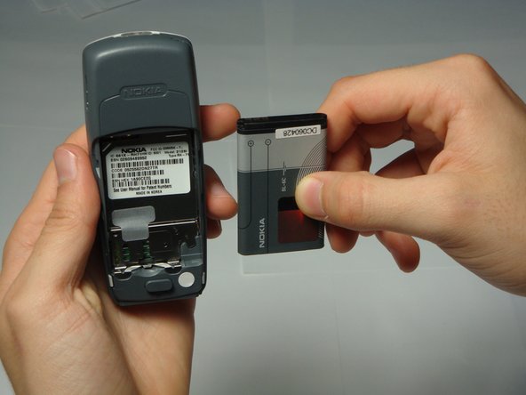

  • Be sure cell phone is off before you begin to disassemble the phone.
  • Press the button on the bottom of the back of the cell phone.
  • Slide rear panel down and remove it.
Image #1 Image #2 Image #3
Add Note Edit Step 2  ¶
  • Using your fingernail, pry the back of the battery upwards and pull out.

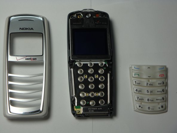

Add Note Edit Step 3 — Faceplate  ¶
  • Insert the plastic opening tool under the faceplate.
  • Separate the faceplate from main body by twisting the prying tool with some force.
  • The faceplate is held by three plastic fasteners, so pry evenly on both sides of phone.

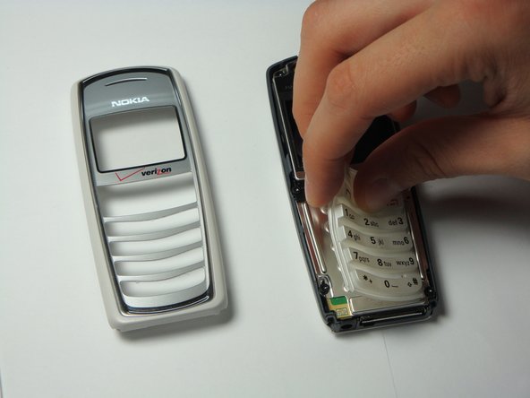

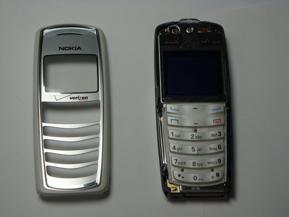

Add Note Edit Step 4 — Keypad  ¶
  • With the faceplate removed, simply peel off rubber key pad and remove.

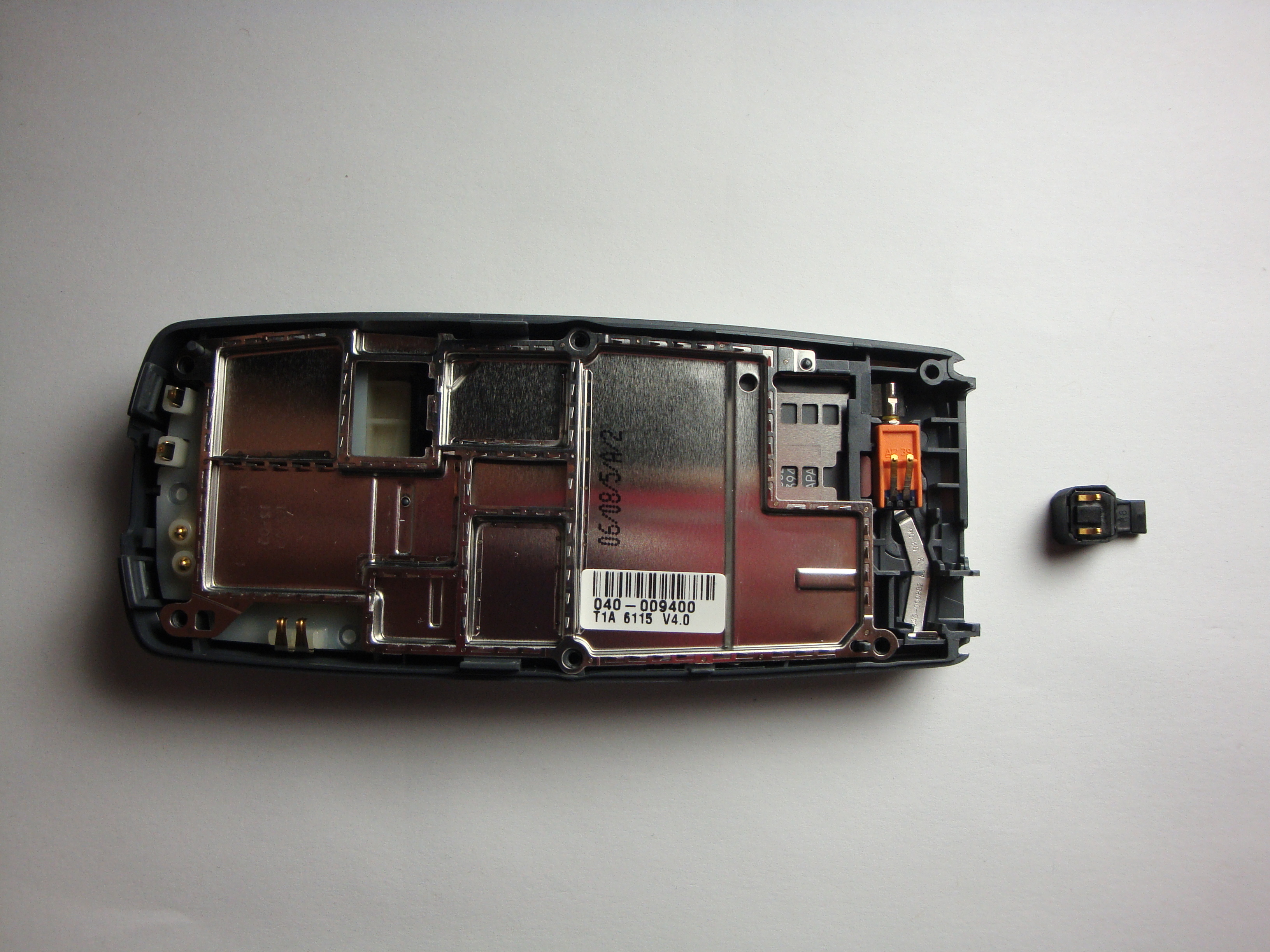

Add Note Edit Step 5 — Motherboard Assembly  ¶
  • Locate and remove the six screws on the front of the phone using a T6 Torx.
    • All 6 screws are 6.9mm long.
Add Note Edit Step 6  ¶
  • After removing screws, lift the motherboard assembly straight off the cell phone body.
Image #1 Image #2

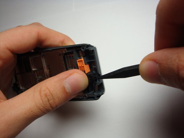

Add Note Edit Step 7 — Internal Clock Battery  ¶
  • With the logic board completely removed, gently pry out the internal clock battery from its housing.
