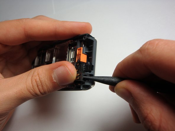

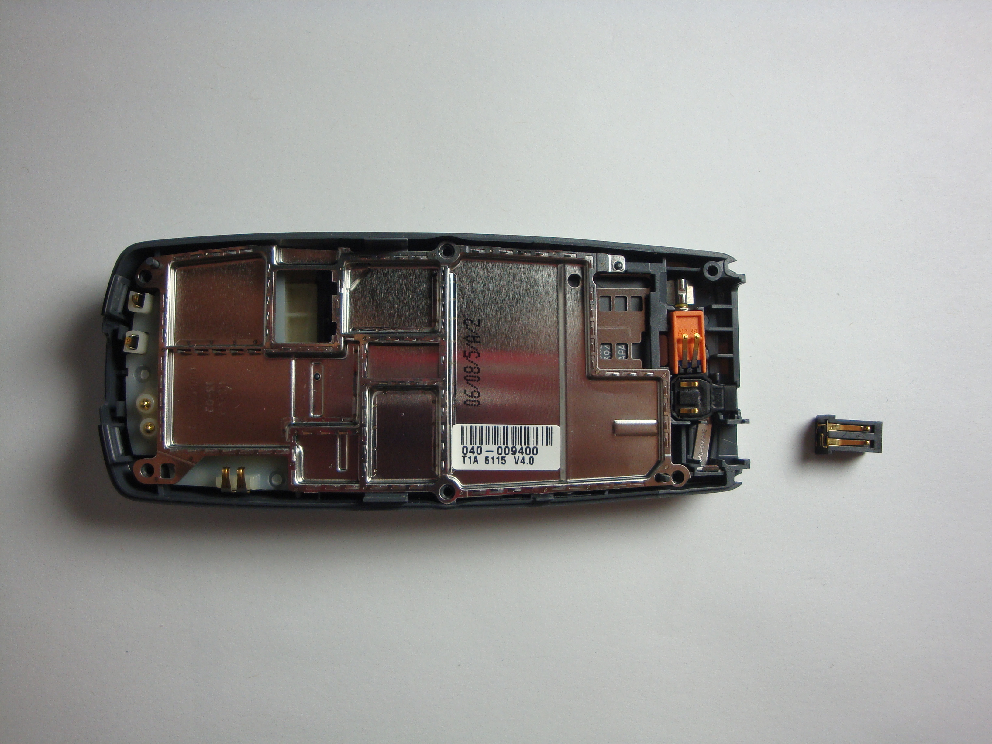

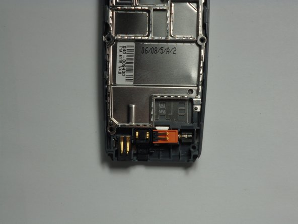

Add Note Edit Step 7 — Charging Port  ¶
  • With the logic board and LCD unit removed, gently pry out the charging port.
