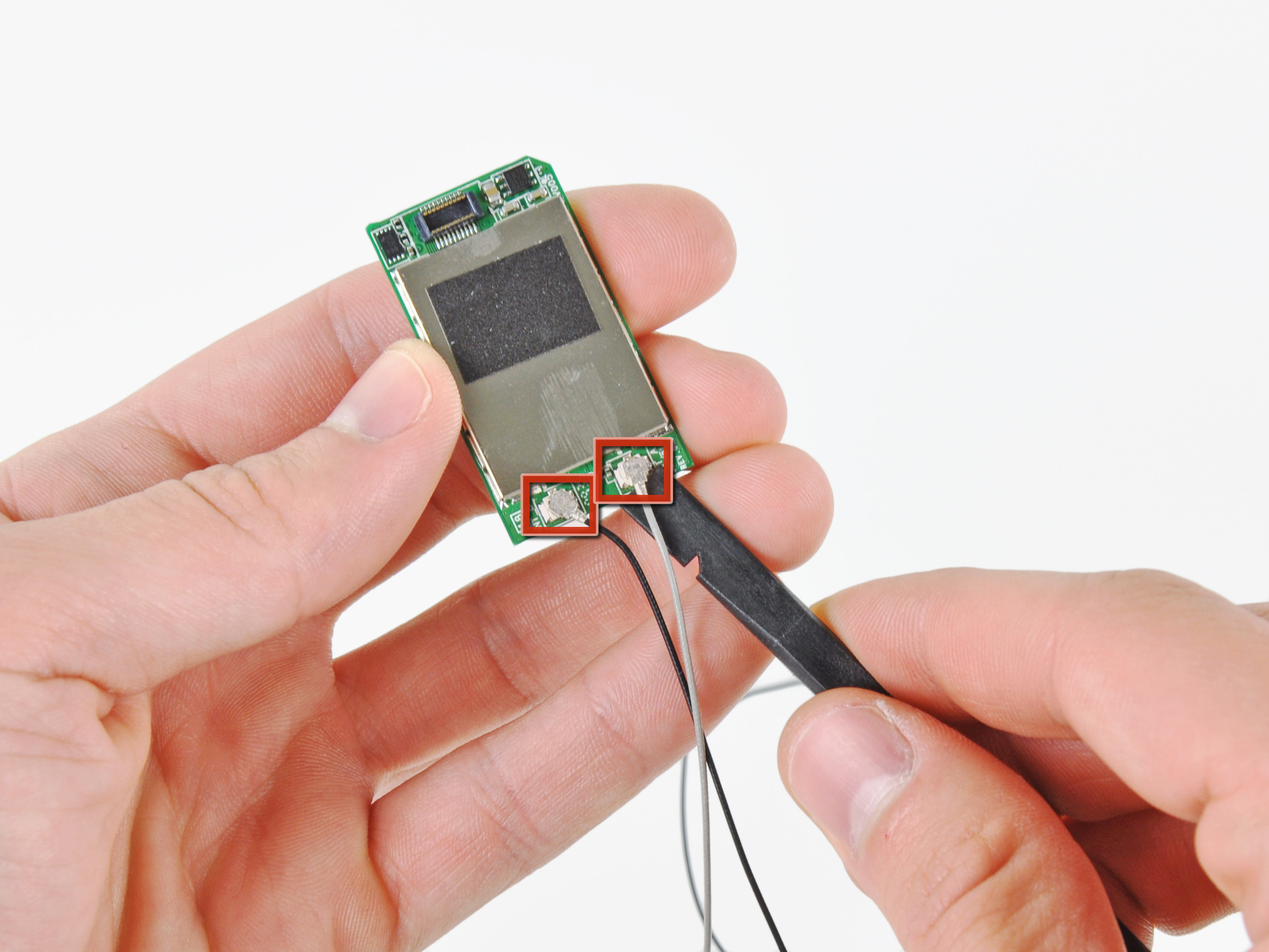

Installing Nintendo Wii Wi-Fi Antennas
Replace broken Wi-Fi antennas on your Wii.
Use this guide to replace the two antennas responsible for providing Wi-Fi connectivity.
Image #1 Image #2
