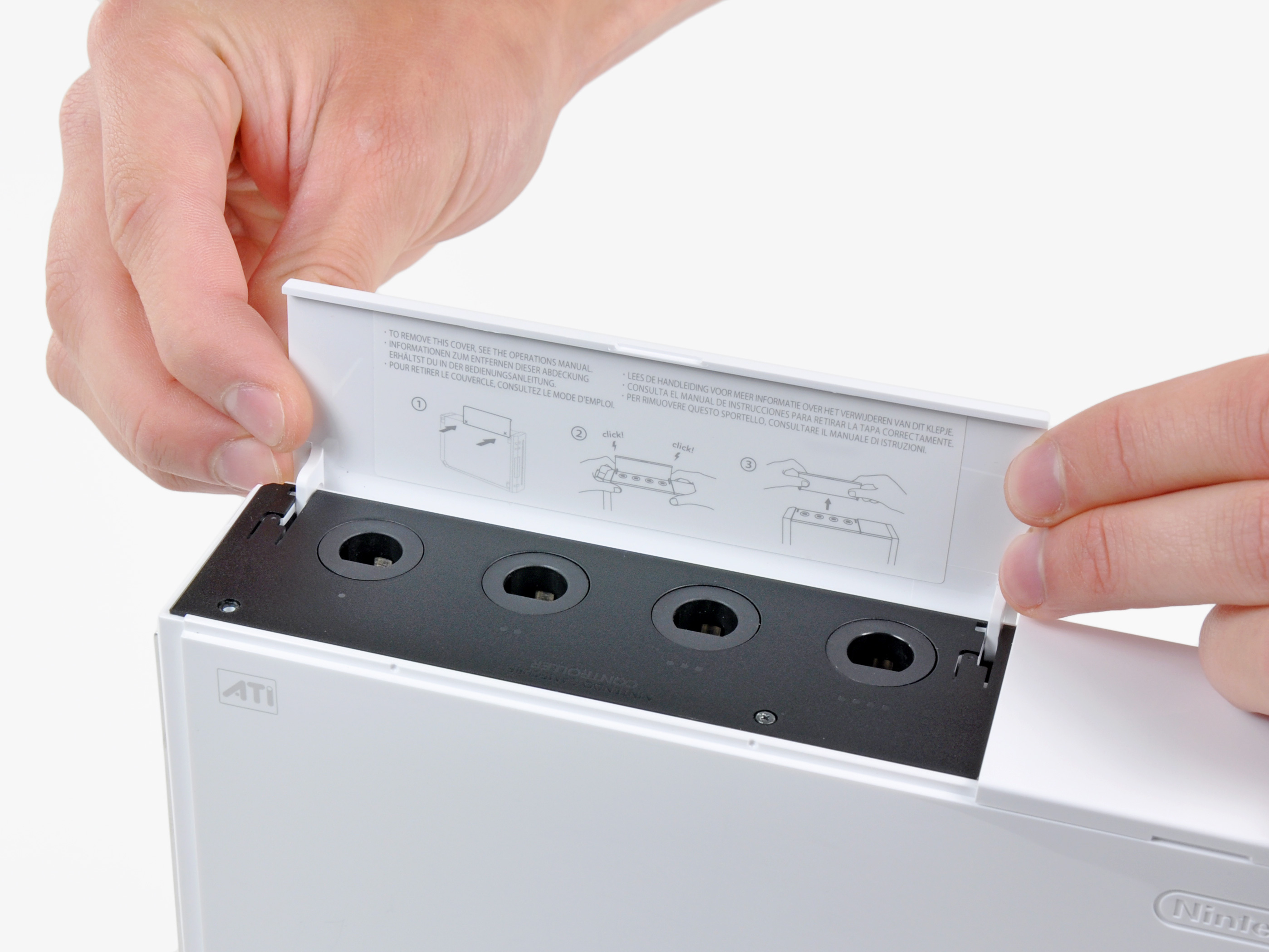

Add Note Edit Step 2  ¶
  • Remove the two 8.3 mm Tri-Wing screws hidden under the covers you just removed.
first image
Add Note Edit Step 3  ¶
  • Remove the single 5.9 mm Phillips screw under the controller port door nearest the faceplate.
