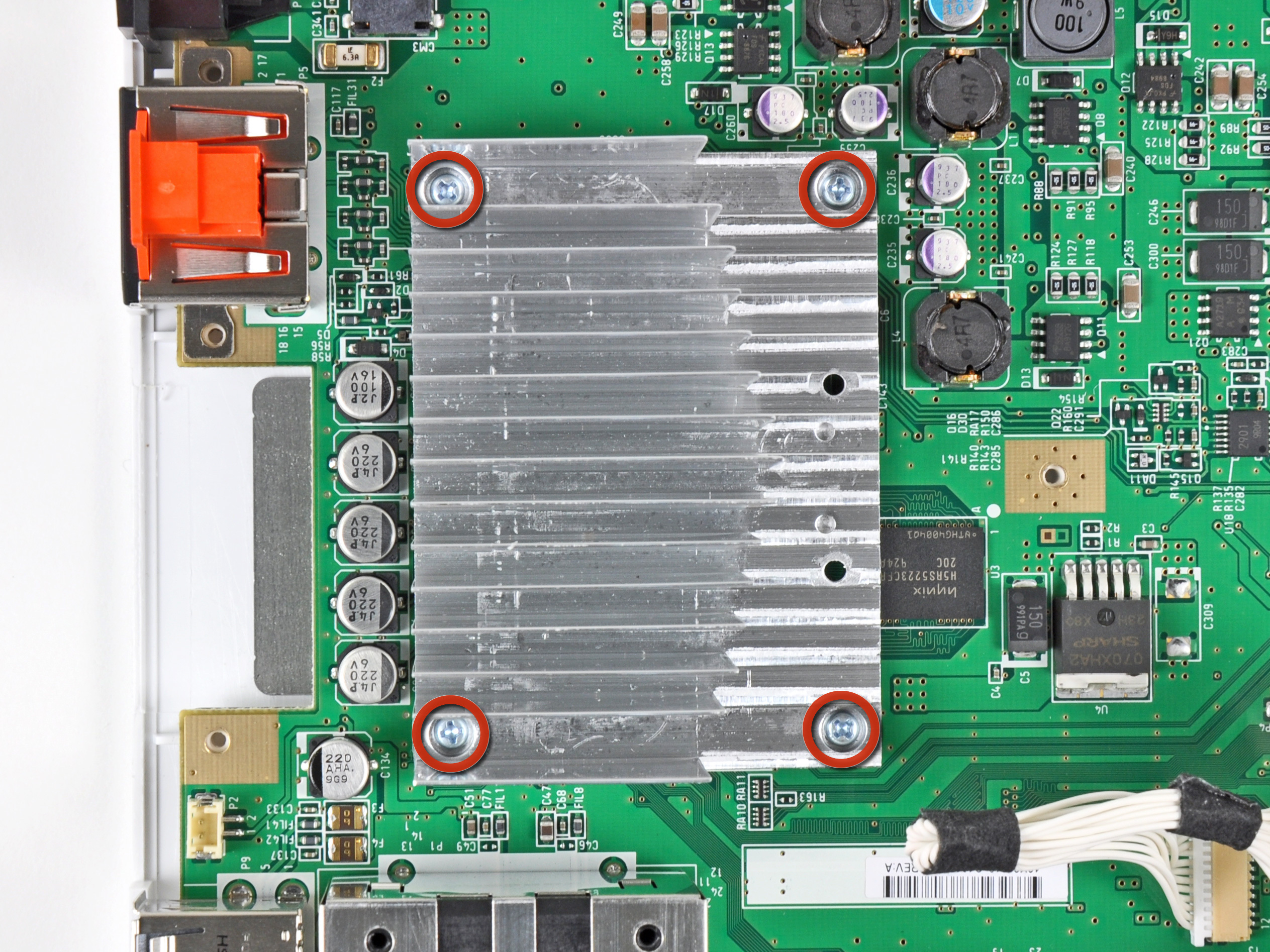

Use this guide to remove the heat sink from your Wii's motherboard.

Add Note Edit Step 1 — Faceplate  ¶
  • Use a metal spudger to remove the white plastic screw covers stuck to the lower case near the front of the Wii.
first image
Add Note Edit Step 2  ¶
  • Remove the two 8.3 mm Tri-Wing screws hidden under the covers you just removed.
first image
Add Note Edit Step 3  ¶
  • Remove the single 5.9 mm Phillips screw under the controller port door nearest the faceplate.
