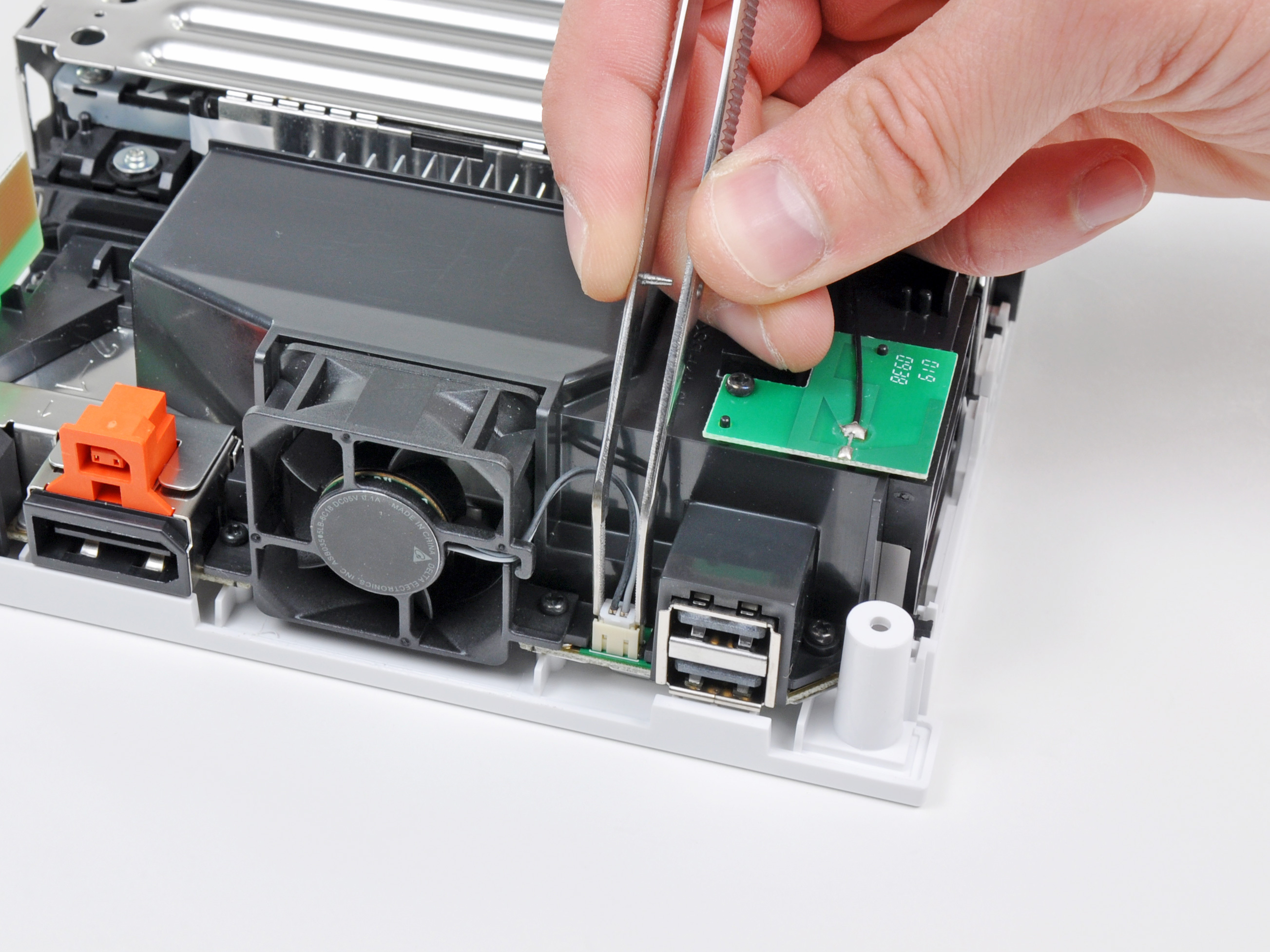

Add Note Edit Step 6  ¶
  • Carefully pull the faceplate away from the front of the Wii.
  • Use a pair of tweezers to disconnect the LED cable's plastic connector from the motherboard.
  • Remove the faceplate.
Image #1 Image #2 Image #3
