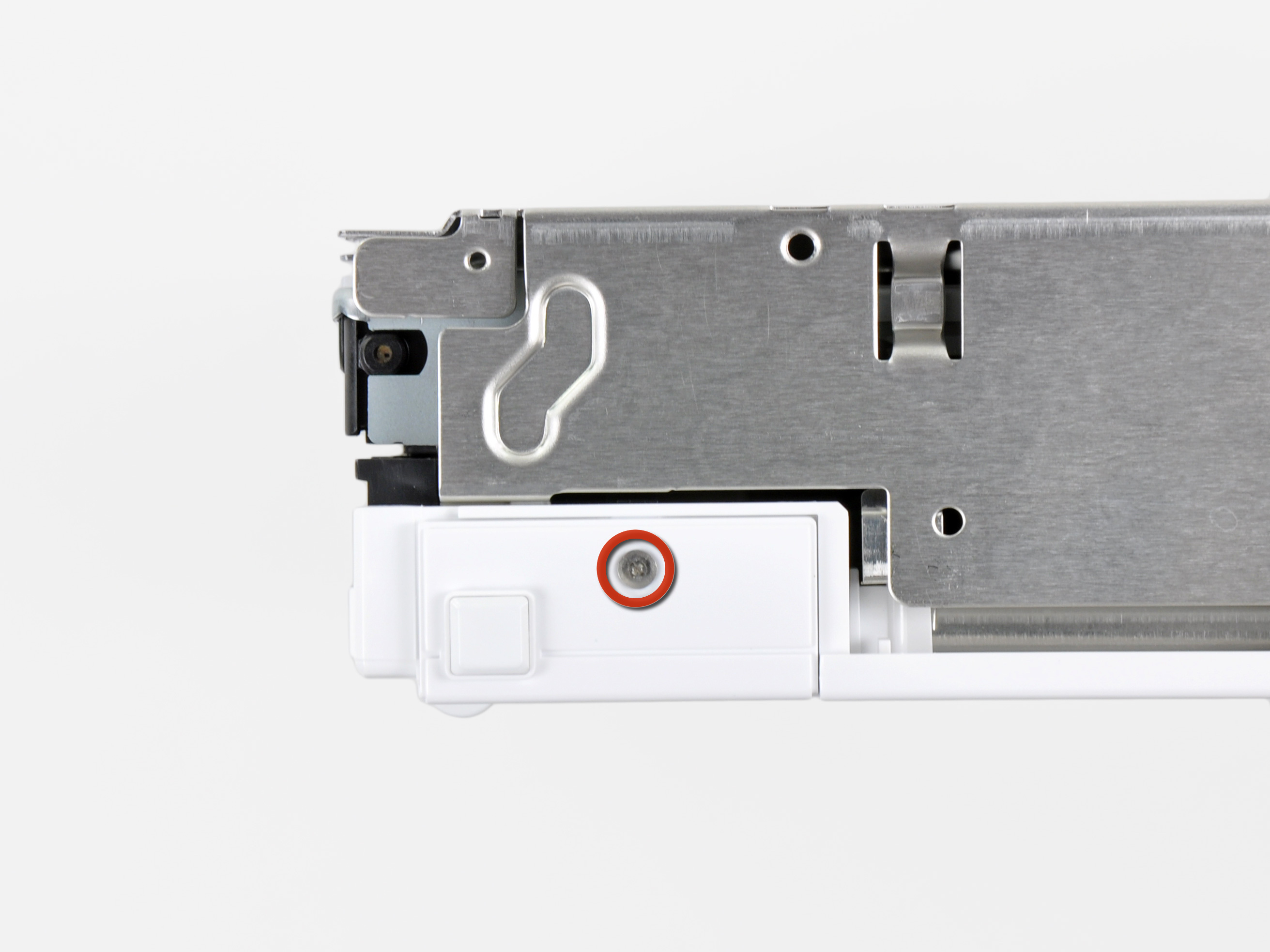

Add Note Edit Step 4  ¶
  • Use a metal spudger to remove the rubber foot stuck to the side of the Wii near the DVD drive opening.
Image #1
Add Note Edit Step 5  ¶
  • Remove the single 5.9 mm Phillips screw hidden under the foot you just removed.
Image #1 Image #2
