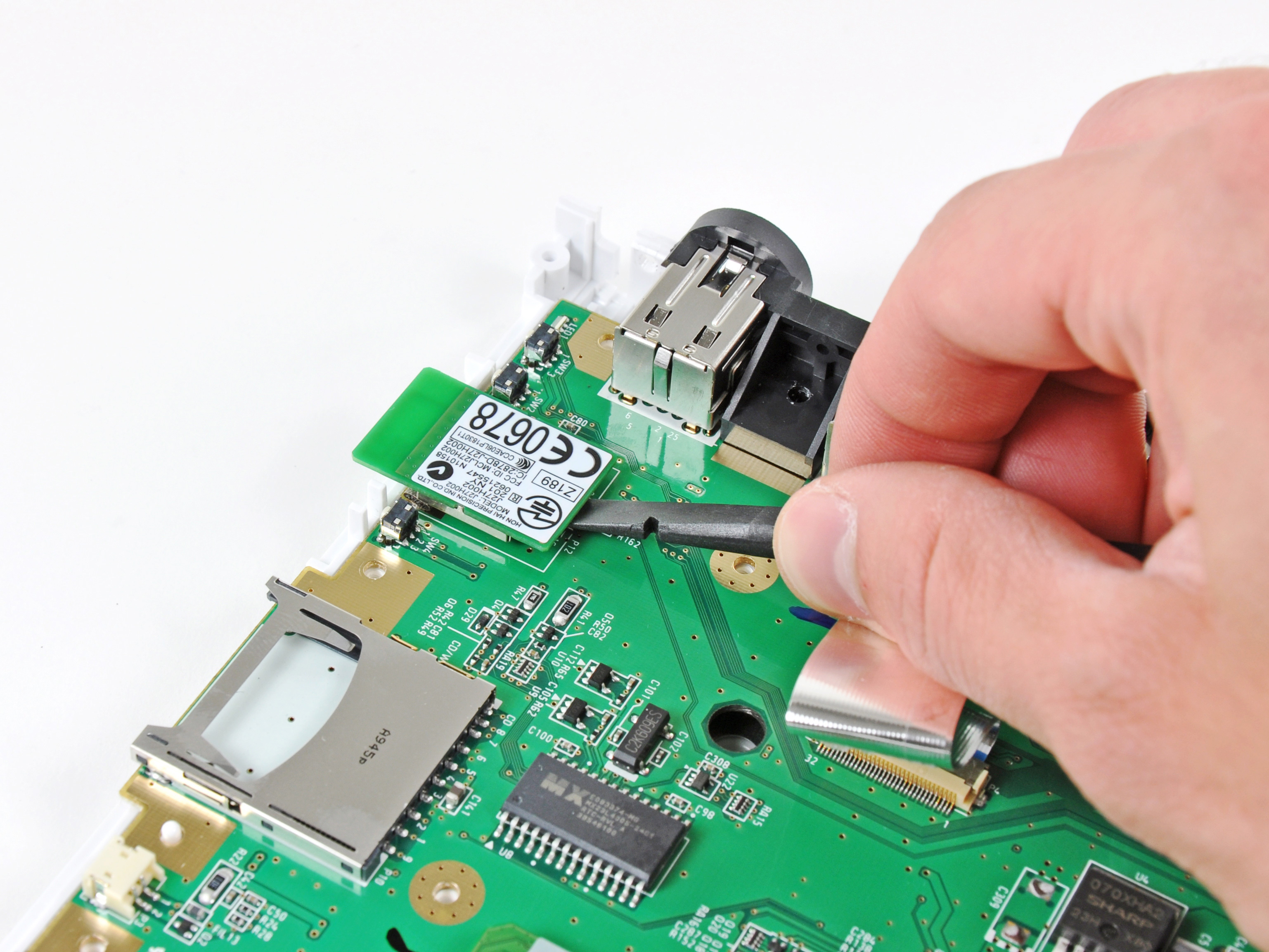

Use this guide to replace your Wii's Bluetooth board. Replacing the Bluetooth board requires removal of most components inside the Wii.
Image #1 Image #2
Add Note Edit Step 1 — Faceplate  ¶
  • Use a metal spudger to remove the white plastic screw covers stuck to the lower case near the front of the Wii.
Image #1
Add Note Edit Step 2  ¶
  • Remove the two 8.3 mm Tri-Wing screws hidden under the covers you just removed.
Image #1
Add Note Edit Step 3  ¶
  • Remove the single 5.9 mm Phillips screw under the controller port door nearest the faceplate.
Image #1
Add Note Edit Step 4  ¶
  • Use a metal spudger to remove the rubber foot stuck to the side of the Wii near the DVD drive opening.
Image #1
Add Note Edit Step 5  ¶
  • Remove the single 5.9 mm Phillips screw hidden under the foot you just removed.
Image #1 Image #2
Add Note Edit Step 6  ¶
  • Carefully pull the faceplate away from the front of the Wii.
  • Use a pair of tweezers to disconnect the LED cable's plastic connector from the motherboard.
  • Remove the faceplate.
Image #1 Image #2 Image #3
Add Note Edit Step 7 — Outer Case  ¶
  • Open the controller port cover until it is perpendicular to the black controller port bezel.
  • Pull the controller port cover straight up to release it from the outer case.
  • Repeat this procedure for the memory card port cover.
Image #1 Image #2
Add Note Edit Step 8  ¶
  • Remove the two remaining 4.1 mm Phillips screws along the top edge of the black plastic controller port bezel.
  • Lift the bezel from the long edge furthest away from the controller ports and remove it from the Wii.
