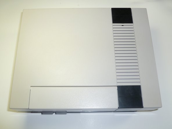

  • Remove the six 13.25mm Phillips screws on the bottom of the game console with a #2.5 flathead screwdriver.
  • The screws are recessed about 40 mm.
  • Flip the game console right side up and take off the top by pulling it up and away from the rest of the device with your hands.

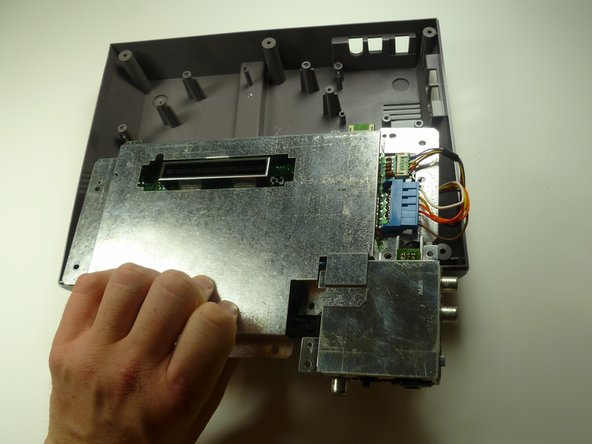

  • Remove the seven 13.25mm Phillips screws from the metal cover with a Phillips head #2 screwdriver.
  • Remove the metal cover by pulling it up and away from the rest of the console with your hands.

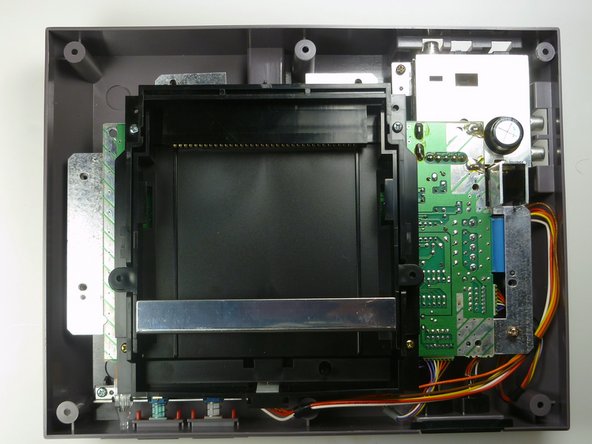

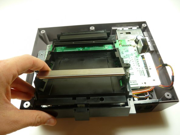

  • Remove the two silver 17.45mm Phillips screws from the cartridge tray using a Phillips head #2 screwdriver.
  • Remove the two bronze 13.25mm Phillips screws from the cartridge tray using a Phillips head #2 screwdriver.
  • Slide the cartridge tray toward you, away from the 72-PIN connector and off the motherboard assembly with your hands.

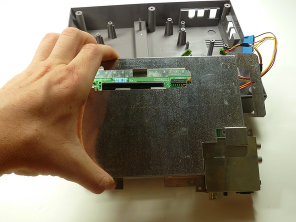

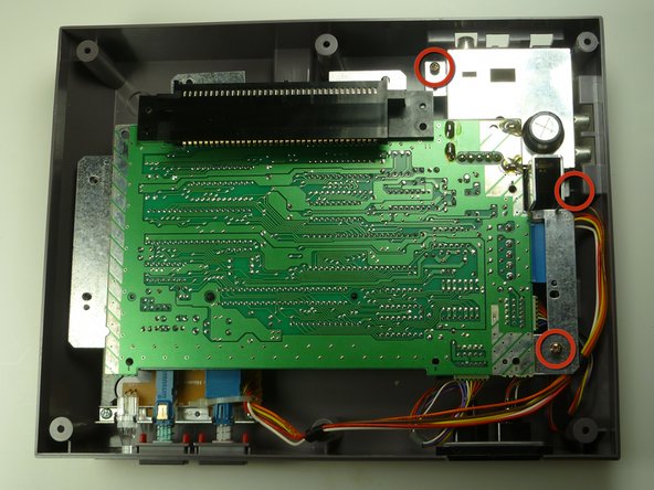

Add Note Edit Step 4 — Motherboard  ¶
  • Remove the three 13.25mm Phillips screws that secure the motherboard to the lower case with a Phillips head #2 screwdriver.
  • Pull the motherboard assembly straight up and out of the plastic case with your hands.
  • Turn the motherboard assembly over so the metal cover is facing you.

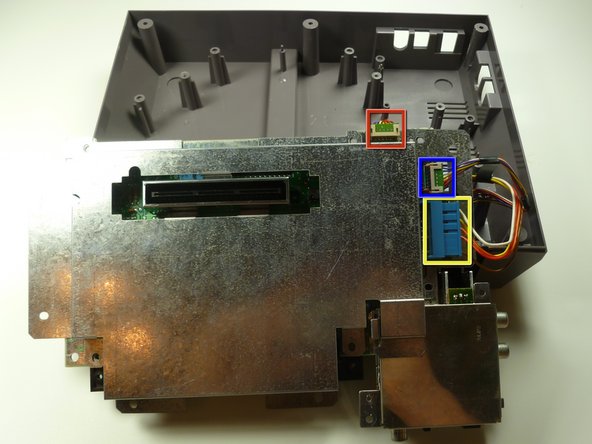

Add Note Edit Step 5  ¶
  • Disconnect the wire harnesses from the motherboard assembly:
    • Player 1
    • Player 2
    • Power
  • Make sure you remember where player 1 and player 2 cables are plugged in; do not mix them up. A good technique would be to write each title on a piece of tape and wrap them around the appropriate wire.

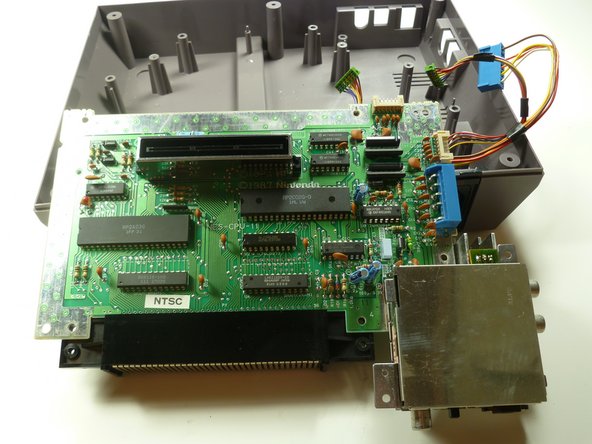

  • Lift off the EMI shield (metal cover)from the motherboard assembly with your hands.
  • Turn over motherboard assembly so the 72-PIN connector is on the top of the motherboard assembly.
Image #1 Image #2

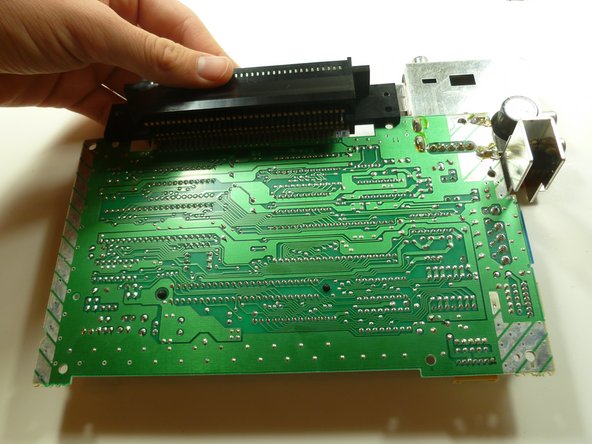

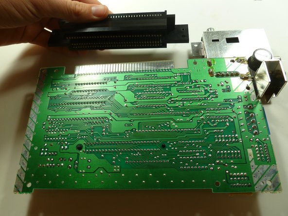

Add Note Edit Step 7 — 72-PIN Connector  ¶

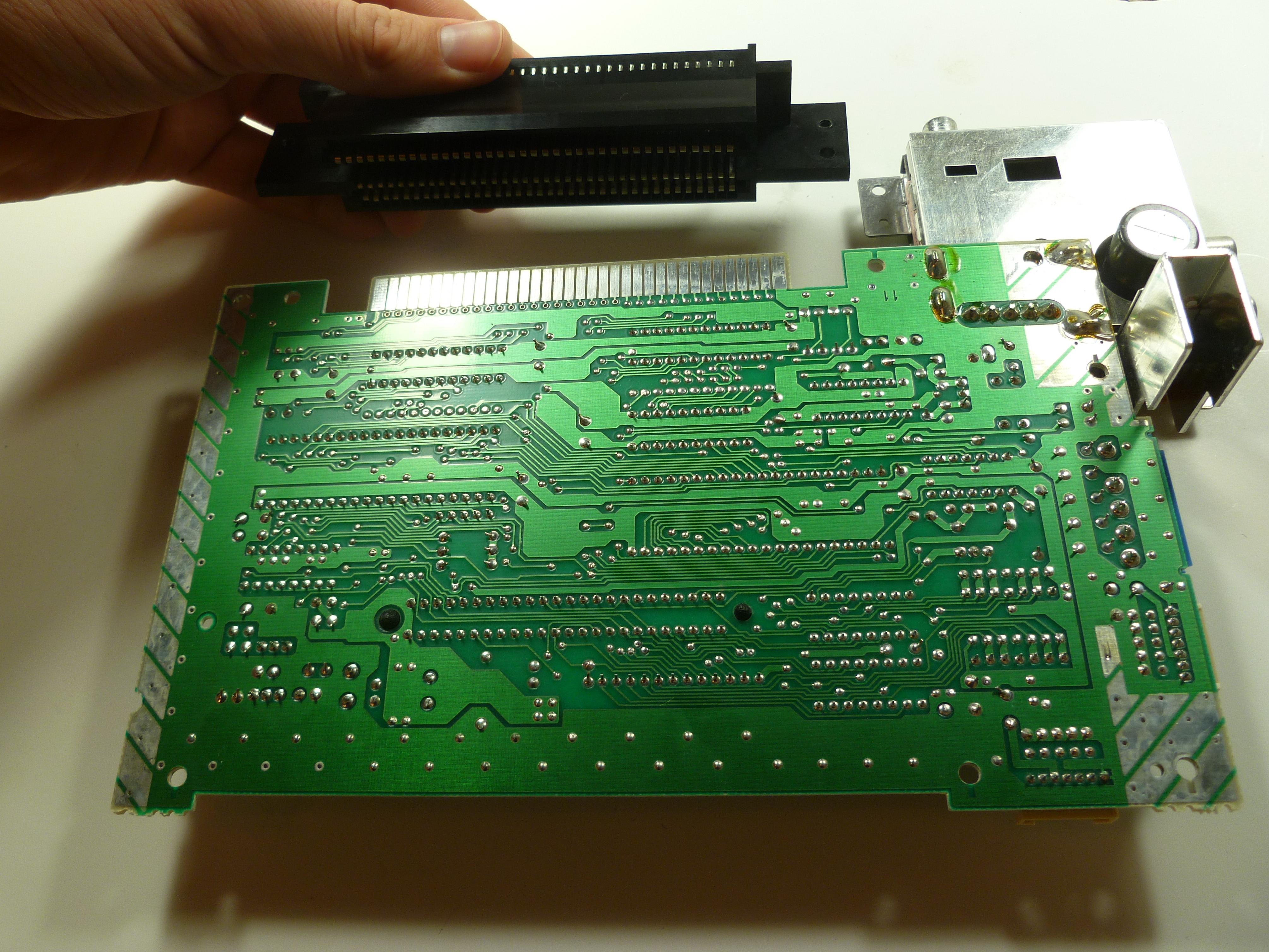

  • Pull the 72-Pin connector straight back and, with a little force, it should easily slide off of the motherboard assembly.
  • Be careful where you place your fingers on the motherboard assembly so that you don't accidentally break off a capacitor, which are located on the opposite side of the motherboard shown in the picture. We suggest you hold the 72-PIN connector with one hand and hold the motherboard assembly along one of the edges or corners with the other.
