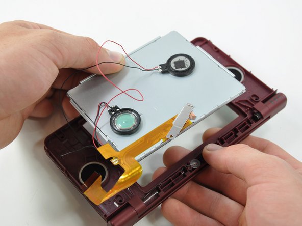

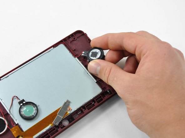

  • Lift both of the speakers from their seats on the front display bezel.
Image #1

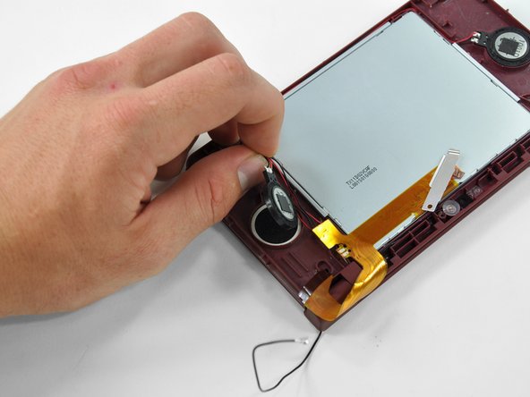

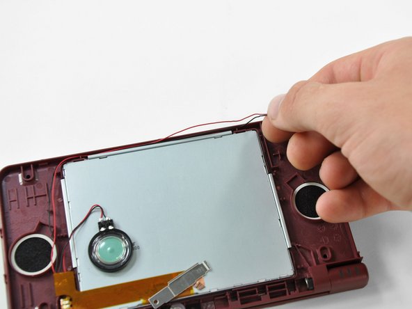

Add Note Edit Step 34  ¶
  • De-route the speaker wires that run above the upper display screen.
Image #1 Image #2

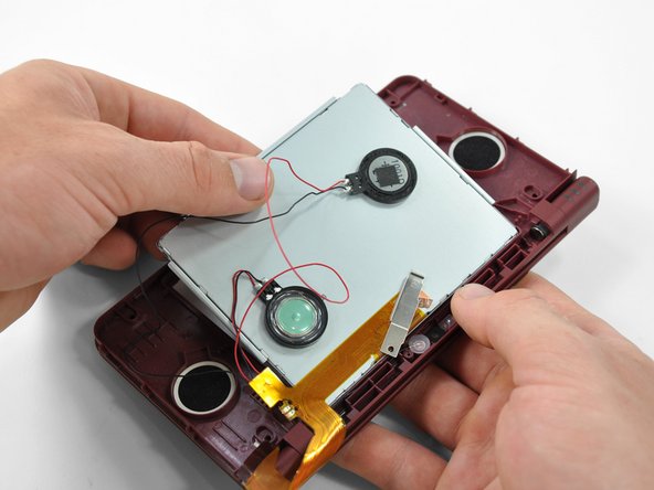

Add Note Edit Step 35  ¶
  • Remove the upper display assembly.
Image #1 Image #2

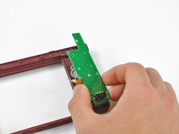

Add Note Edit Step 36 — Upper Case  ¶
  • Remove the seven 2.5 mm silver screws securing the power board to the upper case.
  • Lift the power board off the upper case.
Image #1 Image #2

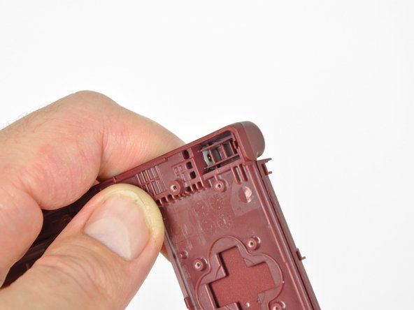

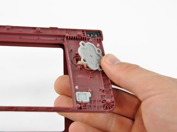

Add Note Edit Step 37  ¶
  • Open the case slightly.
  • Push the directional pad up through the upper case and remove it from the upper case.
  • Push the power button up through the upper case, and remove it from the upper case.
Image #1 Image #2

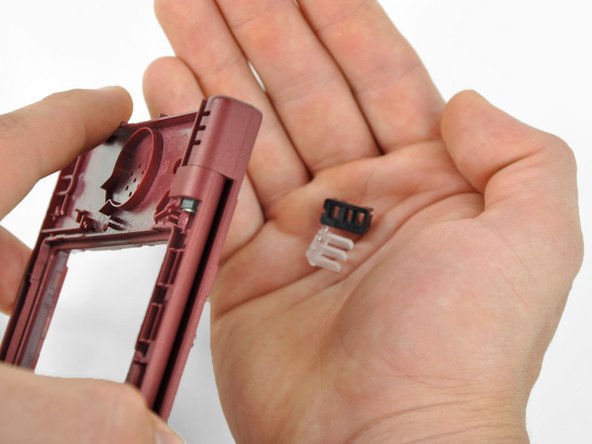

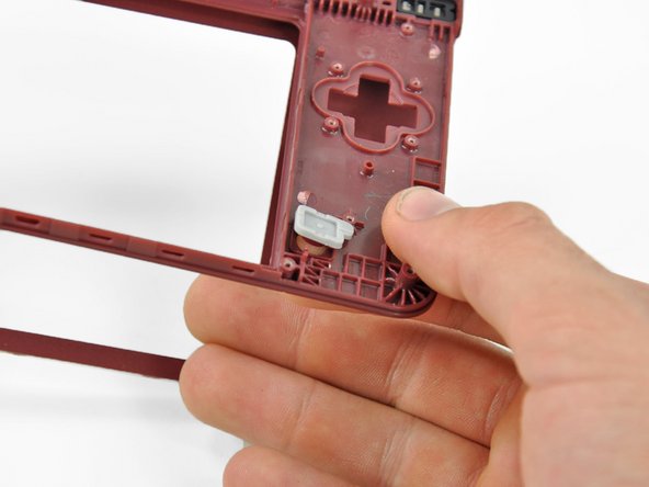

Add Note Edit Step 38  ¶
  • Remove the LED diffuser and black retaining bracket by turning the upper case upside-down and letting both pieces fall into your hand.
Image #1 Image #2

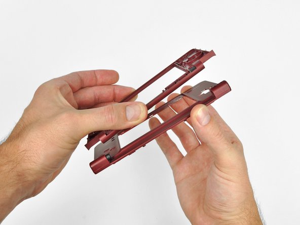

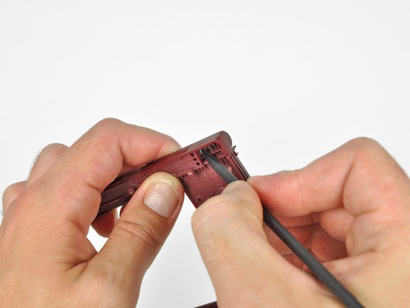

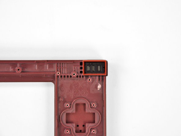

Add Note Edit Step 39  ¶
  • The front bezel is held in place by the clutch hinge on the left side of the DSi Xl=L.
  • Using the tip of the spudger, push the clutch hinge to the left.
  • You will hear a "click" when the clutch has been completely displaced. Some force will be required.
Image #1 Image #2

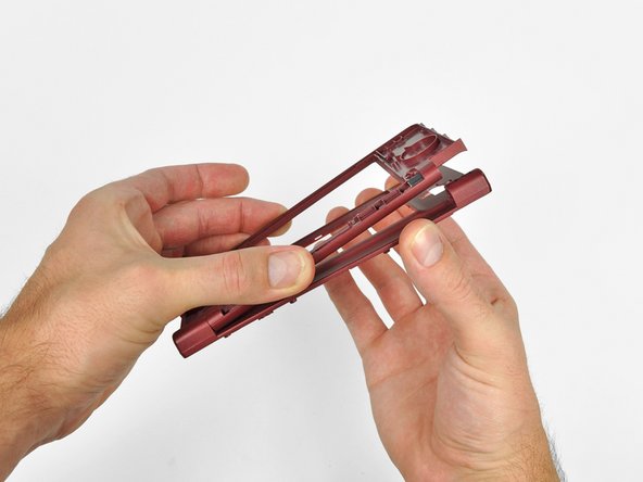

Add Note Edit Step 40  ¶
  • Lift the front bezel off of the upper case, tilting the left side of the front bezel away from the upper case first.
