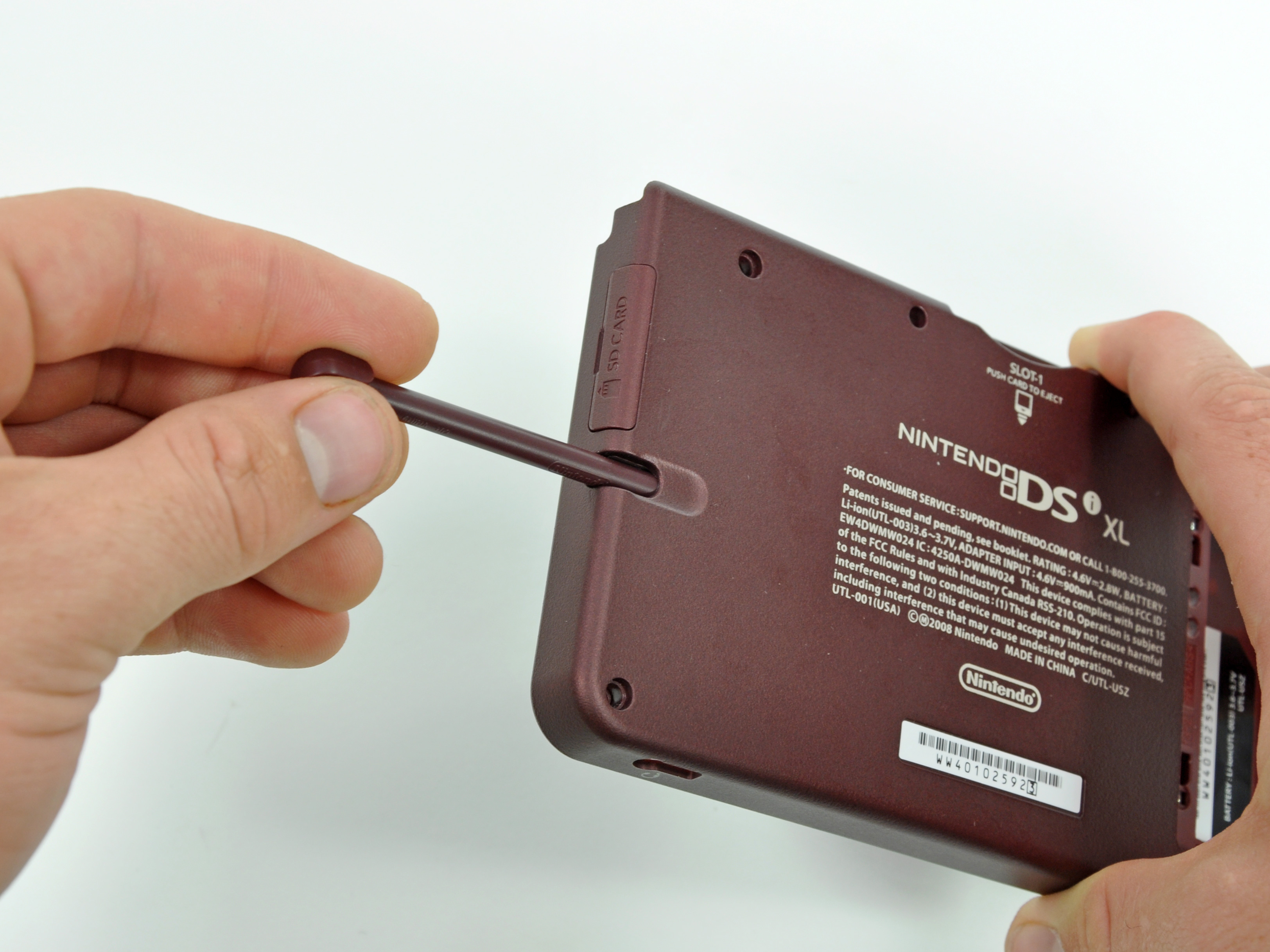

Installing Nintendo DSi XL Stylus Housing
Replacing stylus housing.
Is your stylus stuck? We're here to help.
